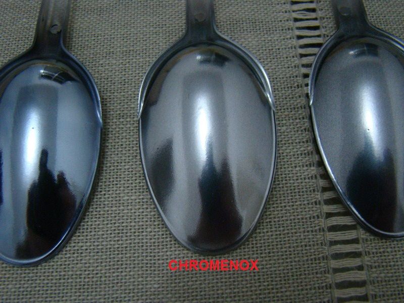

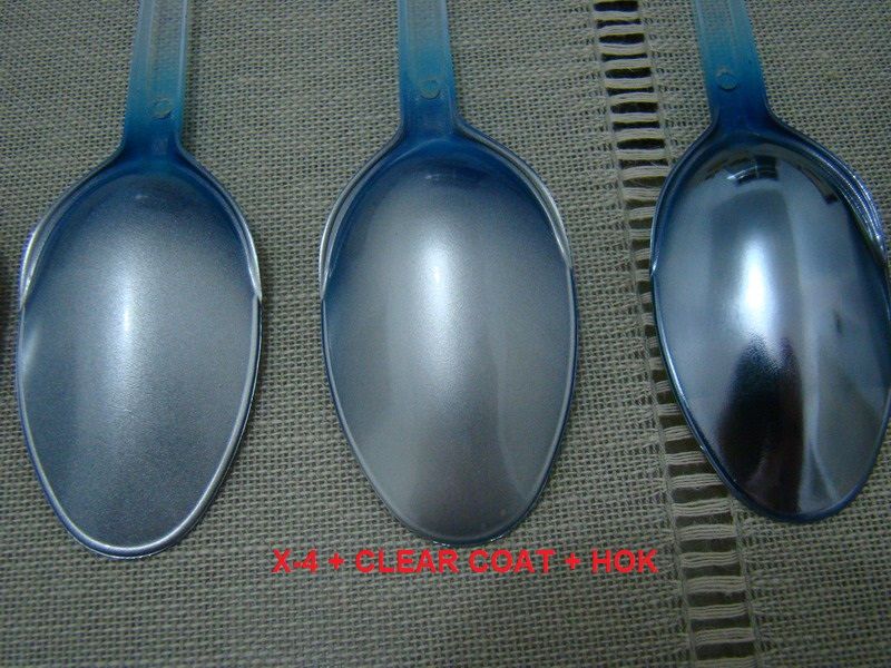

Another test....
Spoons were all painted this way: primer, tamiya X-1, automotive poliester clear coat, then chrome. We will notice the "orange peel" because they were not polished.
Now I have to apply clear coat in all spoons and check the result.

Why was a clear coat applied between the X-1 and the chrome finish??

To have a shiny finish before applying the chrome.

I prefer to use TS14 as a base. It can be applied gloss right from air-brush and then polished to mirror like appearance
using polishing pads and polishing compounds. Less coats and faster as well.

with clear coat
bonus: X-2 + CLEAR COAT + MGM CHROME = RESULTS IN YELLOW
