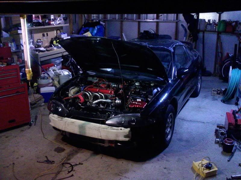

Went to the garage this evening. I love Summit Racing. Ordered fittings on Sunday, arrived today standard shipping.
I installed the 90* fitting on the oil feed and started her up to see if it would spin, and sure enough she's spinning strong now. Granted I didn't run her for too long since I was in the garage and was being smoked out like a bee's hive, but she spins.
Installed panels and hood today. Have to trim, up the bumper more because the IC piping moved, so the old cuts don't match up anymore. PLUS, the hood has to be trimmed. Once of the braces sits right on top of the manifold causing it not to close all the way on the passenger side. Wasn't too happy about that, but not a big deal. Just going to grind down the one brace.
Then have a small coolant leak and not sure where... looks like its dripping by the back of the block, so picking her up this weekend and seeing where that's coming from. Maybe the drain plug isn't in all the way or something. And still running stupid rich.
Looking like a car again!

Awesome, I cant believe that was the problem. Your old feed must have been really bad.

With the manifold being so close to the hood will that burn the paint on the hood?
  #224
Old 11-11-2009, 08:33 AM
david-b's Avatar
david-b david-b is offline
Dave is THAT guy
Join Date: Nov 2003
Posts: 6,868
Thanked 7 Times in 6 Posts
Re: david-b's 95 Eagle Talon ESi-T Motor Build
What paint? Unpainted CF hood. And the clear coat is already peeling all over. Looks like shit
No it shouldn't, my hood get so hot you cant touch it in the middle and the paint is fine.
