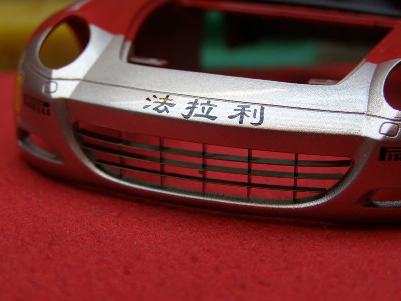

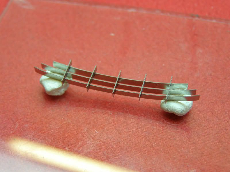

I started off by putting together the p/e front grille.

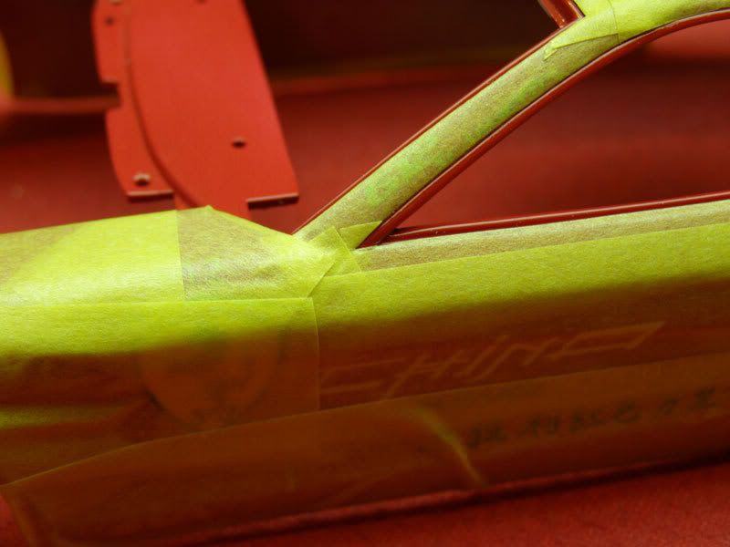

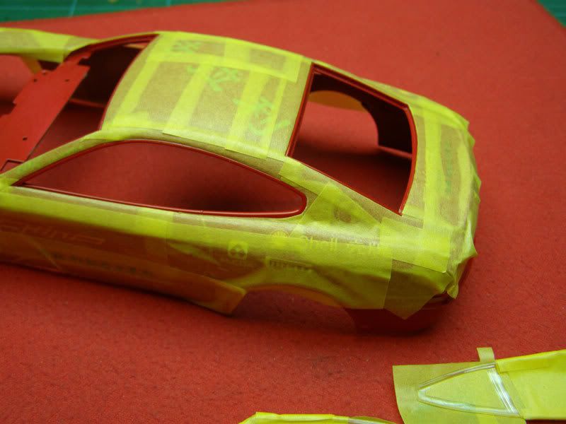

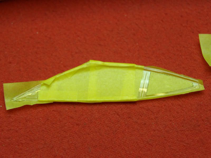

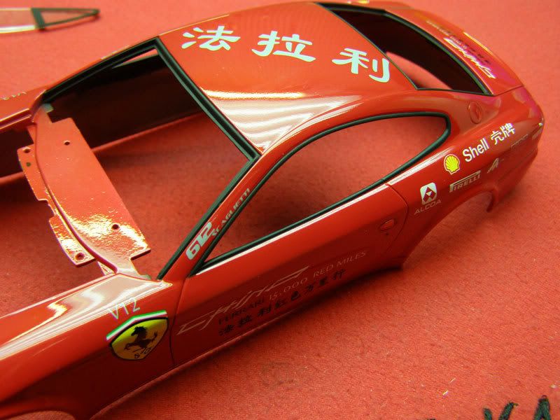

Then huuuuuuuuuuuuuuuge amounts of masking
All the interior to put down the black trim, the window surrounds and the side windows - 3 days' worth in total. phew!!!

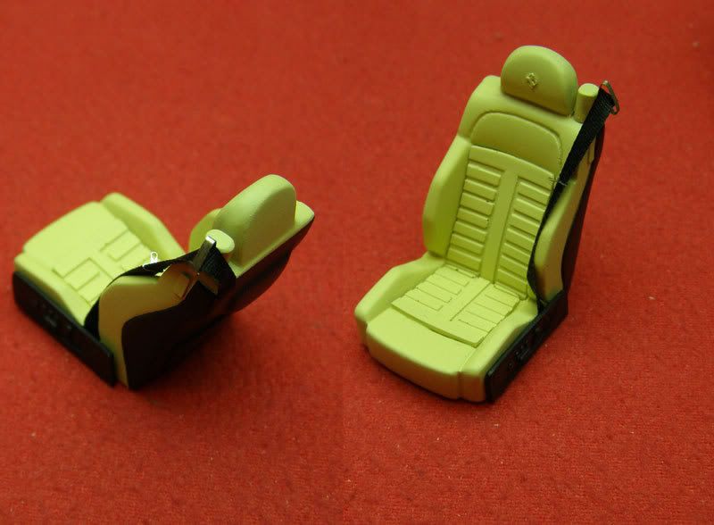

Seat has been detailed with craft ribbon and spare p/e sprue.

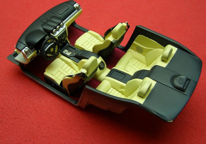

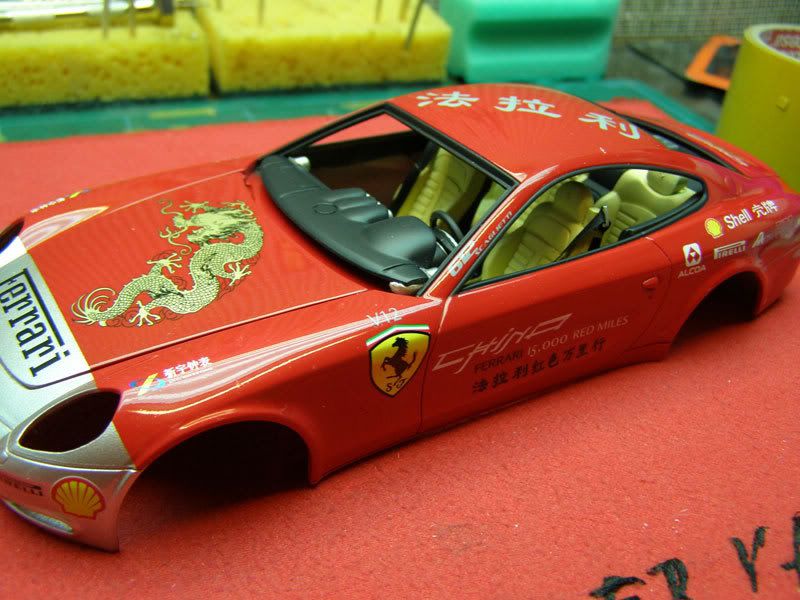

Test fit of the interior so far and a mock-up.

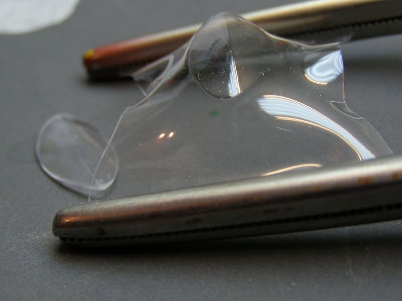

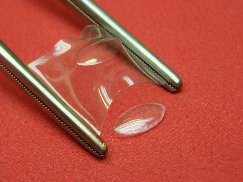

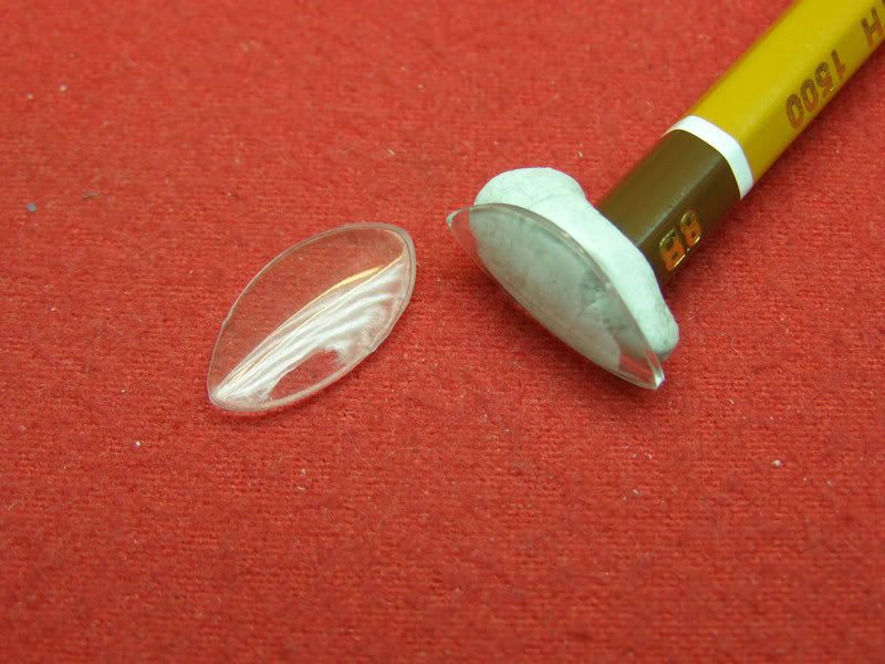

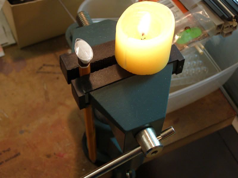

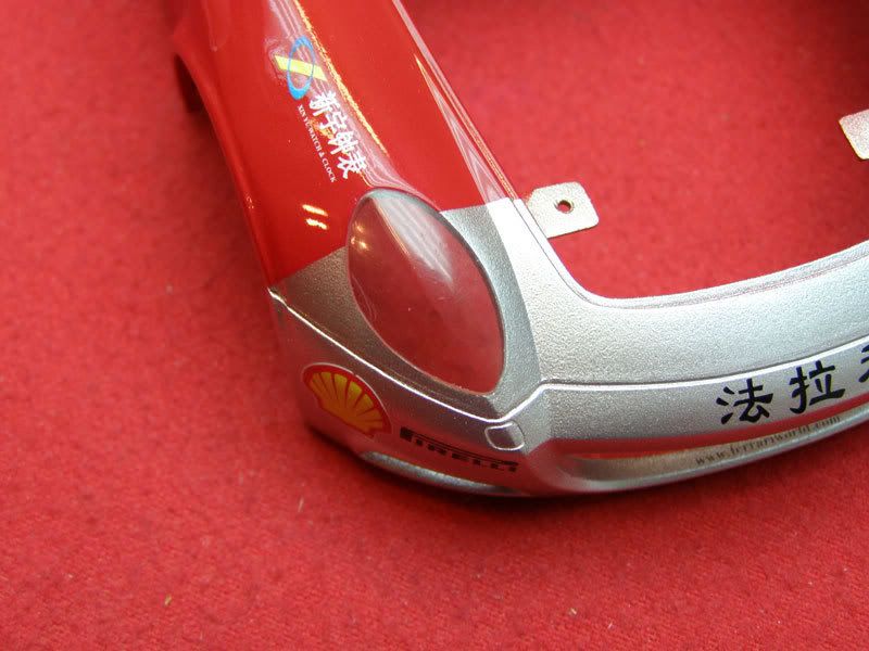

New headlight covers.
The kit parts are quite thick and don't sit very well so I tried to see if I could do any better using smash forming technique. Seems to have come out pretty OK and I will probable go with these.

I like the replacement headlight covers.

It's good to see this again. Excellent job with the window trim and great idea with the headlights. This is one beautiful model.

Looking good! What paint did you use for the window trim and dash, etc? It looks very smooth and very good. Nice!

Superb job on window trims mate!!!!

Thanks guys
It feels good to be doing her again (oops!) but her sister will still be sitting in her shoe box and will be there for some time yet I fear
I used Vallejo Air Acrylics (my favorite paints)
the mix was:
  • 4 drops of Vallejo thinner nr 061 (in my experience Valejo hates Tamiy thinner and also the Vallejo thinner has some kind of satin varnish properties IMO)
  • 4 drops of Vallejo Black nr 057
  • 1 drop of Black grey nr 056
