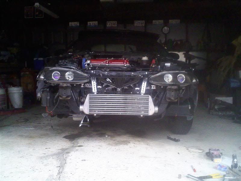

Big progress made today. I got there nice and early today after not being able to sleep last night and was excited rolling in. I finished mounting up the tranny to the block and getting the rest of the mounts in. I start hooking up the slave cylinder to the fork and adding in fluid. The slave and the fork look a little 'off'. Something about it didn't look right, and there was no play at all on the fork. I called Jason (my hero for the week BTW) and told me there should be play. I pulled the little rubber cover off and see the fork wedged between the pressure plate and the little pivot ball in not in place. I was pissed thinking I would have to pull the motor again. I seperated the tranny from the block as much as I could without releasing the whole thing, and after ~25 minutes of trying, got the fork on the pivot ball and on the TOB properly. You could just tell that it was in the right place then. Best pic I could get of it...
Once this was all fixed, I filled up and bled the clutch. My god this thing is stiff and feels like a clutch. The last 2 I had always had a soft touch, where you couldn't feel where it was being disengaged. This one it's obvious. Feels great. Have to workout my legs a little more though. City driving will be hard with it.
Once that was in, I had to reinstalled the alternator and the crank pulley (pulled off yesterday) and did the belts, rechecked timing, got the PS all up and hosed, and attached all the wiring. Those saying that it would take forever to find where each harness goes... I think I've done this too many times... took 2 minutes to hook them all up (I timed myself )
I then made my mounts for the FMIC and redid some of the piping. Drilled out the broken stud from yesterday and welding in a new stud. Did some painting. Basically got everything in the car. Made HUGE progress today.
So tomorrow, I'm taking the day off of work and finishing her up and take the hoist back. I have to pick up some extra fuel line since some SS I ordered is still on backorder, reattached the lower cross member, fully installed the manifold, turbo, WG, and make a custom DP, and it's ready to fire up. MSns is not fully wired, so will use stock ECU for all control to begin with at idle here. I don't plan on it leaving the garage. Hopefully I have no leaks and it's perfect straight out the box. Wish me luck for tomorrow.
Pic at about 6pm tonight.

Wow dave that looks amazing. I hope you aren't using the stock ECU to control those 750s? There is no way in hell you will be able to run that much injector with the stock ECU. Other than that everything looks good. Do you happen to know what lb pressure plate you got? Im betting you are getting a stiff pedal from warn out hydrolics. Even thought they aren't leaking, them being warn is causing your pedal to be stiffer. My looked to be in perfect shape but I went ahead and changed them my last clutch change and wow what a difference. I would recommend this for anyones car thats 10+ years old.
Also can you get a few more pics of the manifold wastegate and downpipe area. Im just trying to get an idea of mine.

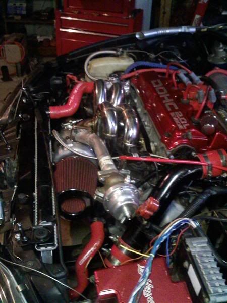

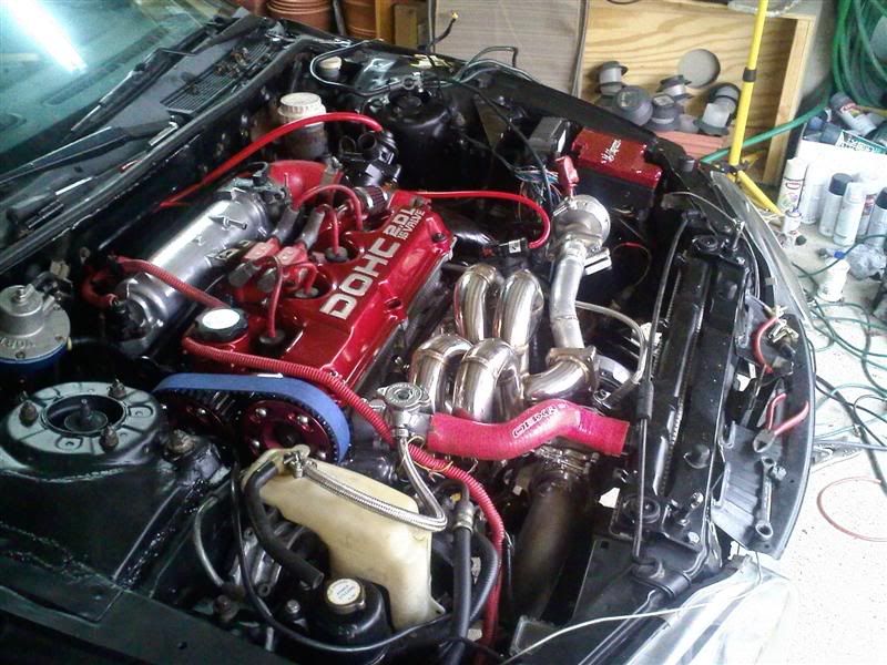

Got some more work done today. Let me start off by saying, I hate this manifold. So many things about it suck. I broke the T-Stat housing trying to bend that out since the one tube is dead against the hose then and wont fit right. Plus, my turbo is so big that it's a PITA to get it all fitted properly with that damn WG flange right in the way. WTF were they thinking. I had so many problems with it, I nearly pulled it off and put the log-style back on. I hope to god that this thing does not cause any problems once it's altogether. I recommend not buying it, or putting it on. My .02.
</rant>
Because of that, I didn't get to finish her up today. I worked ~12 hours on her and she's so close, but not quite yet. Let's see what I did..
-Installed crossmember and finished back of block wiring
-Fully mounted manifold
-Mounted turbo
-Made WG pipe and mounted that. Need to make dump tube now
-Ran ~95% of vaccuum lines (no turbo)
-Redid melted wiring harness by timing belt
-Did some wire tucking
-Finished all fuel lines
-Started on new DP. This is actually what slowed me down then. If you look at my tutorial I have in the tech section, I made a little 4" sectional to connect the DP to the flex pipe. Well I had enough pipe to get rid of that. I started cutting and welding, and called it quits tonight on that... too tired.
I'm betting the stiffer clutch pedal is from it being a heavier clutch. I don't remember the rating, but it was a ~375lb torque capable plate or something like that. It feels perfect. When I was in Dustys car last year, it felt just about the same. Feels perfect to me now.
So what's left is to finish the DP and finish MSnS. I don't know when the next time I will be there will be though.

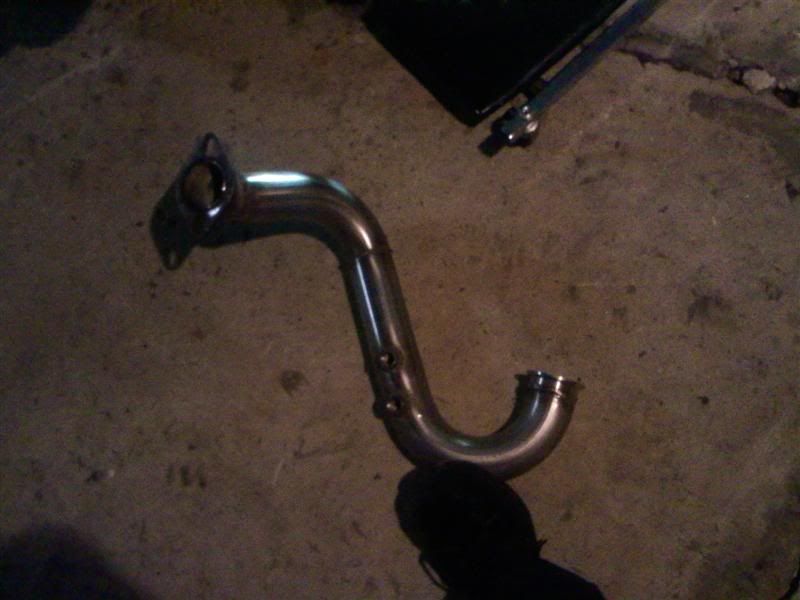

Since I'm throwin a HUGE Halloween party tomorrow, I decided to work on the car this cold, rainy Friday night. I finished the DP (Started out good, but that last piece of fab to match up always sucks for me), ran SS fuel line on the return, and finished the IC piping. Also bunch of random other crap too.
Pics...
Downpipe with V-Clamp at turbo. Connects to my modified GST flexpipe then.
Pic of it installed along with the IC piping leading to the FMIC and oil return. Tight fit. I may wrap the DP by the IC piping to protect against heat.
