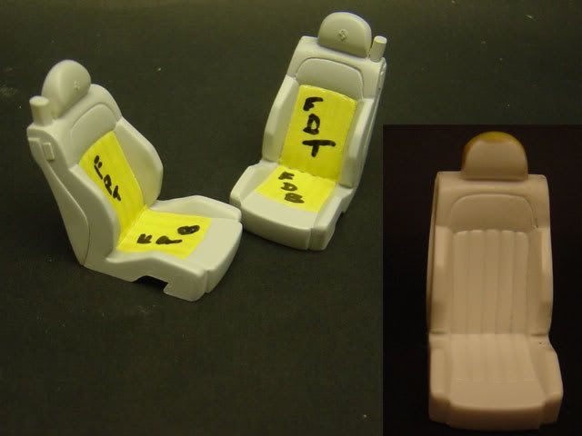

Just so you know, the redhead of this pair of China Girls has seats with the "Daytona" upholstery pattern – so of course Revell kindly decided to mold the kit with the other style
This has brought my build to a grinding halt for the past 2 months. The prospect of modifying this just totally daunted me.
On top of that, it come just after Tang shared his mind boggling seats with us – talk about a hard act to follow...
At first I was pretty intimidated by the idea of changing the pattern but then I remembered hiroaki's great 550M thread with his scratch built seats and this put an idea in my head that seemed feasible.
Basically my plan was to grind down the Revell pattern, make a master “Daytona” pattern, cast it, cut out shaped inserts and glue them in place. Sounded simple enough.
Now some pics for those of you who don't like reading my prose
First thing I did was to carve off the molded in seat belts, add some styrene bits to simulate hardware and put p/e cavallinos on the headrests. (FYI at some point in the process I mixed up some bottles and tried to wash the seats with acetone – that's why they look so crap )

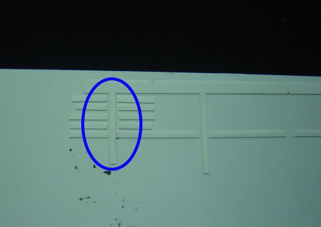

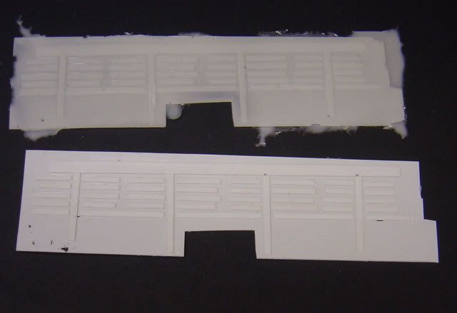

Next thing was to make the pattern. I did this by cutting 1, 1,5 and 2mm strips of styrene and cementing them to some styrene sheet. One master for the front seats ad one for the rear seats.
This was pretty time consuming and tedious and I started rushing it – first paving stone on the road to hell...
and so on and so on....

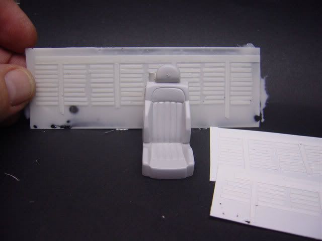

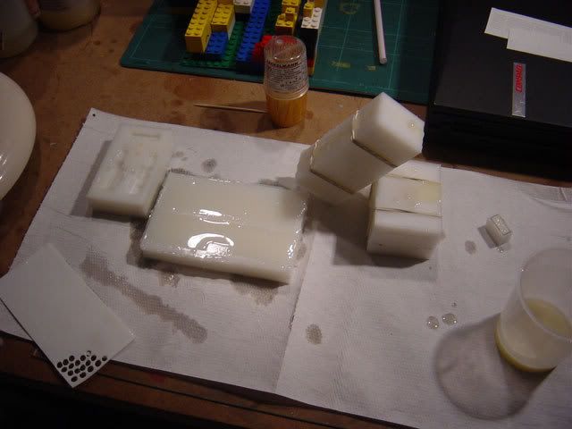

Once I had my 2 masters I made a silicone mold of them.
I decided to make resin copies because my assumption was that the chances of me cutting and trimming to a good fit first time were less than zero and I really didn't feel like cutting another million little styrene strips.
With a mold, I could simply re-cast another set.
From the mold I could cast two wafer-like copies (This picture shows the resin copy and the styrene master)

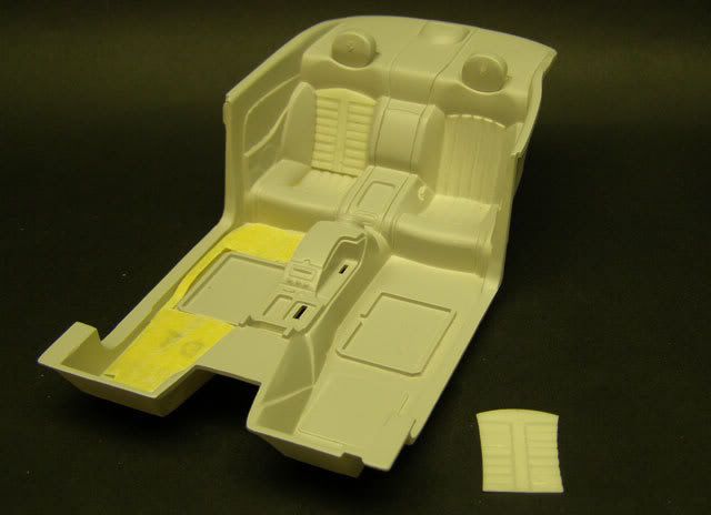

Here you can see the cast pattern with the seat.

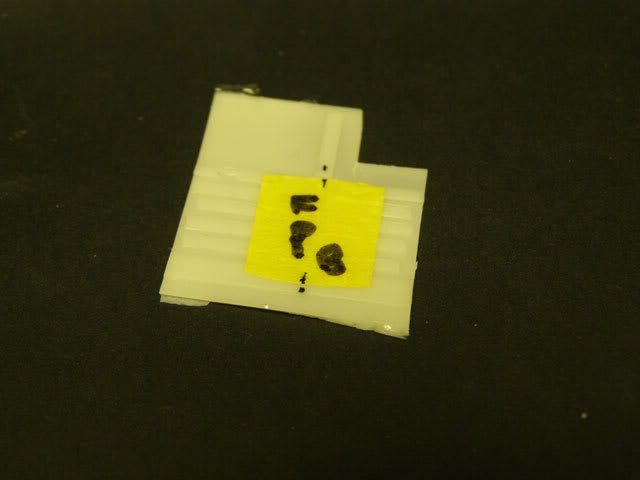

The resin master was cut into the appropriate 8 pieces, the templates applied and the pieces cut out.
This is a test fit of the first panel.

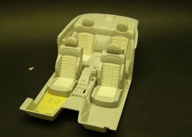

This is a test fit of all 8 panels in place.

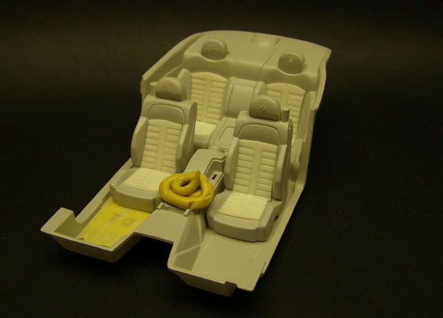

I try to be an honest critic of my own work.
IMO this was a pretty good idea that didn't work out as well as it was supposed to. Not because the idea was bad but because I just didn't execute it well enough :[
I gave myself an award for this update – the Klutz Krap Award.
Here is a picture following the awards ceremony:
I'm going to paint it up and see how it looks when the whole car is put together. I fit still looks crap, I have a spare kit and I can try again.

That aside, if you're unhappy with the result, why not remove the whole area with the pattern from the plastic seat completely (as in to the point when there is a gaping hole in the sear ) and insert your resin Daytona pattern instead?

Prize isn't well deserved , really the result seem good: as Ales said all you need is mill down original (crappy, those desreve prize) pattern and smooth out a bit dayto shapes, would be more "soft".

Just a question: Do you glue the resin on the seat without sanding down the (old) pattern a little bit ??
