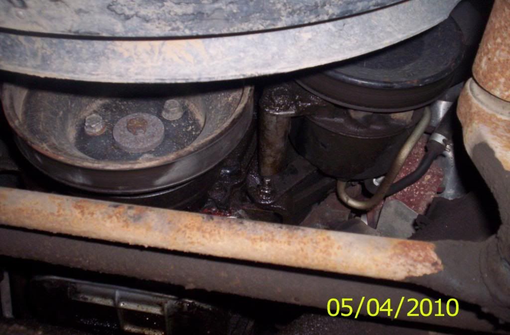

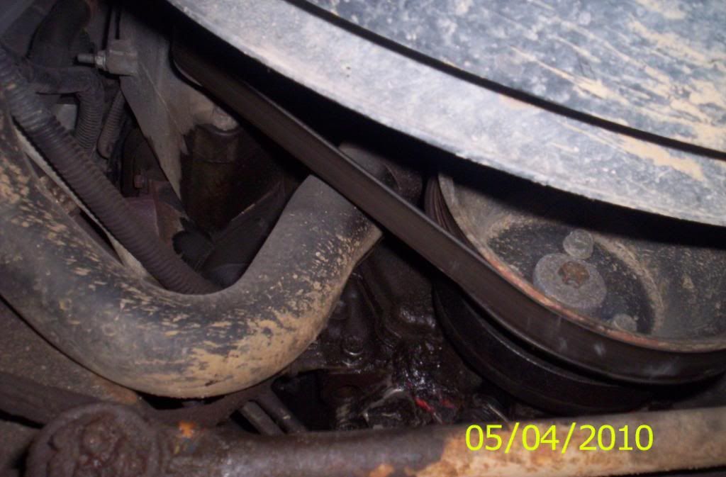

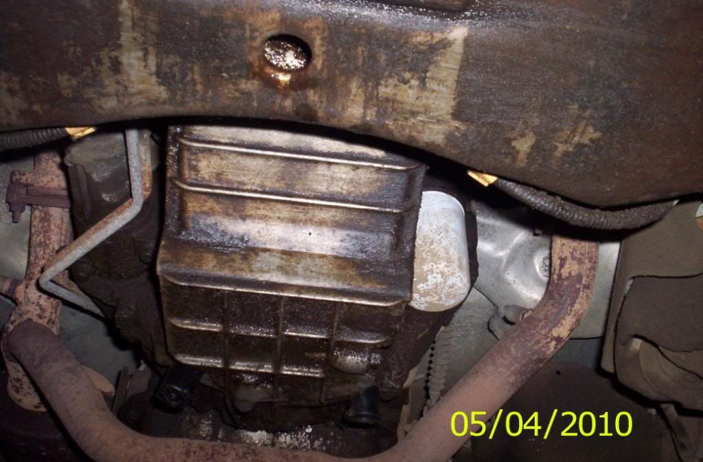

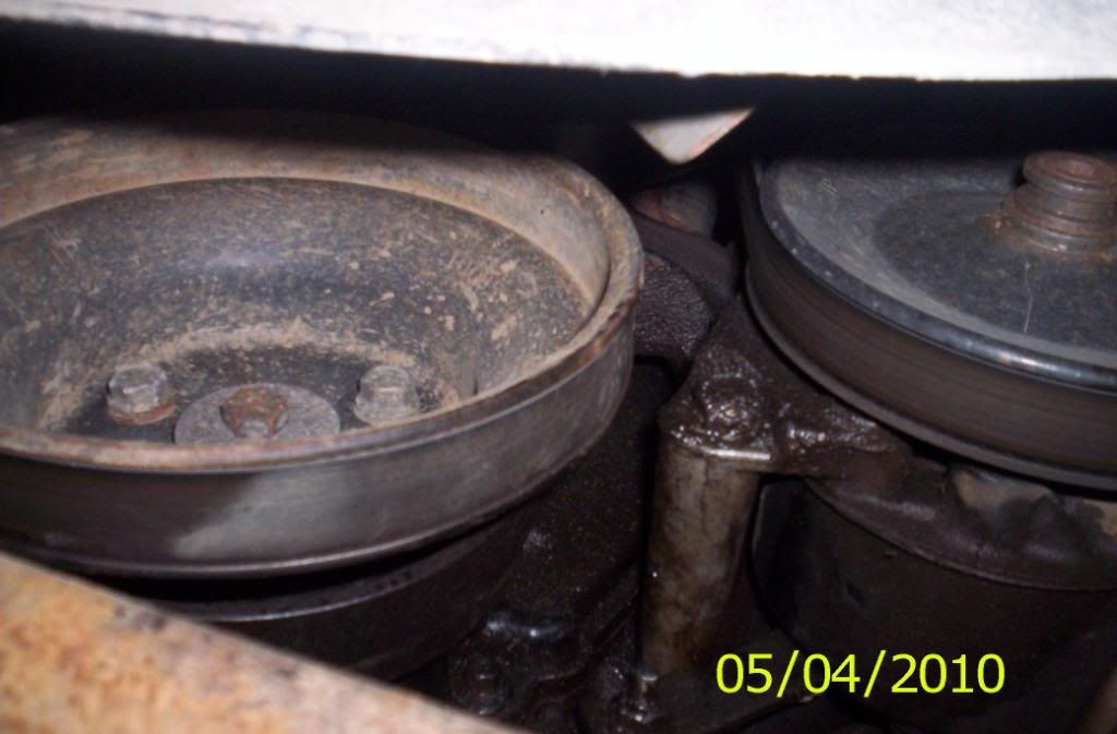

Its leaking oil bad. Must be the front seal cause it looks to be thrown all over. But it could be the timing cover too, theres some orange sealer i can see that looks like someone tried to fix the leak.
So not reallly sure if its front seal or timing cover or both.
Do i have to remove the water pump to get the timing cover off?
If i pull it all apart i plan on using gm rtv (grey sealant) like i did on my northstar motor. Way better than that orange crap i found on there currently.
Heres some pics, i get 20 drops on the ground in about an hour so it needs fixing.

Good pictures but to find the leak.
You will have to clean/wash off old oil and run engine and then look for where is is leaking.
Let us know where it is leakin and then we an help you.
