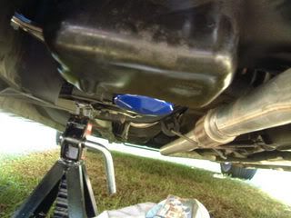

1) Find a place to mount your oil cooler, I choose to mount mine behind the vent on the passenger side of the bumper. I had the most room here and also gave a short route to the oil filter. I had to remount some parts in that area to get the oil cooler up high enough where it wont get caught on anything. I had to make some brackets to mount the oil cooler.
2) Drain the oil from the oil pan and remove the oil filter, install your fittings onto the sandwich adapter. (Use teflon tape on the threads) Install the adapter where your old oil filter just was. (Put some oil on the o-ring to make it seal good) I put lock-tight on the adapter nut to keep it from coming off when I change oil filters in the future. The fitting point to the right side of the car.
3) Mount your oil cooler and measure your first line. Attach the fittings on it and install it on the car. Do the same for the second line. Go ahead and put your new oil filter now. Your oil filter is going to sit about ¾” lower now which will put it lower than the oil pan. I used the Purolator Pure One L10193 oil filter because it’s shorter and sits even with the oil just like before.
4) Make sure your oil lines aren’t going to get caught up in the belts and pulleys, or hit the tire when you turn. Go over all of your fittings once more to make sure you tightened all of them. Add about 5 qts of oil to your motor. Disconnect the coil pack and fuel pump and turn the motor over for a little while to pump the oil into the oil cooler. Check the oil level and add oil if needed. Crank the car and let it run for a few minutes. Shut it off and wait about 10min, check for leaks and the oil level to see if you need to add more. It took about 5 ½ qts to fill my car up.
