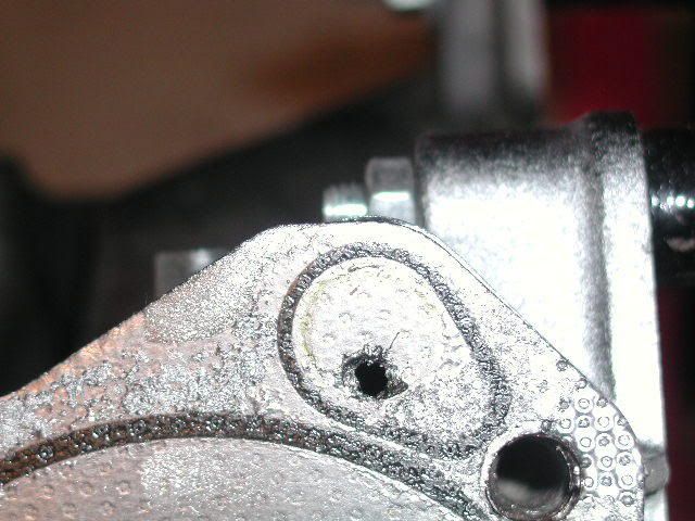

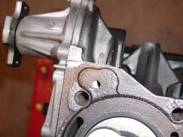

You can not see the oildrain back holes unless you pull the head. There are numerous pictures over on teamswift. Link is in my post above. You will need to pull the head and replace the headgasket. Make sure you widen the hole and make sure the check valve is in place to. It help control the amount of oil going to the head.
Just found pics of my reman engine that I actually opened up to make sure that the drainback holes were wide enough and that check valve was in
drainback holes are in this pick upper right and upper left hand corner and
check valve is the copper color thing inthe bottom left of this pic below:
You can see the miss match openening for the headgasket. I widened the holes in the gasket and reused the gasket and headbolts, all is well!!
