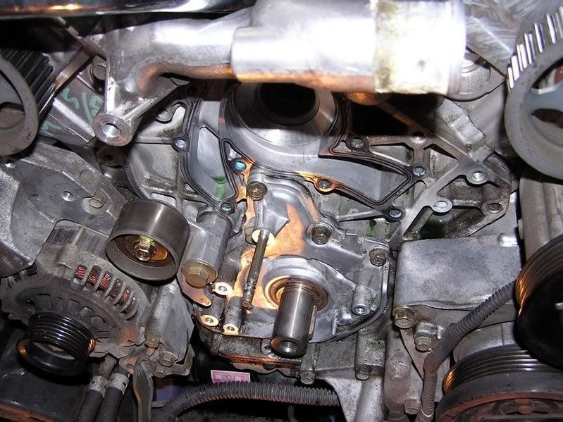

Here are some images to inspire you:
This is with everything removed and the belt ready to come off. I didn't have to remove the power steering pump; remove the three mounting bolts and lever it out of the way. Also, the radiator can stay in place, though, don't damage it; I used an impact to remove the crankshaft pulley bolt and had plenty of clearance with the radiator installed.

Photos:
http://i104.photobucket.com/albums/m...deotiming2.jpg
http://i104.photobucket.com/albums/m...deotiming1.jpg

Hello. Nice ride. In the first picture, it shows both the TENSIONER PULLEY and the TENSIONER ADJUSTER. In the second picture, it shows just the TENSIONER PULLEY, and it looks like the TENSIONER ADJUSTER has been removed. My question is, what is the one that starts making noise when it is getting to go south?
