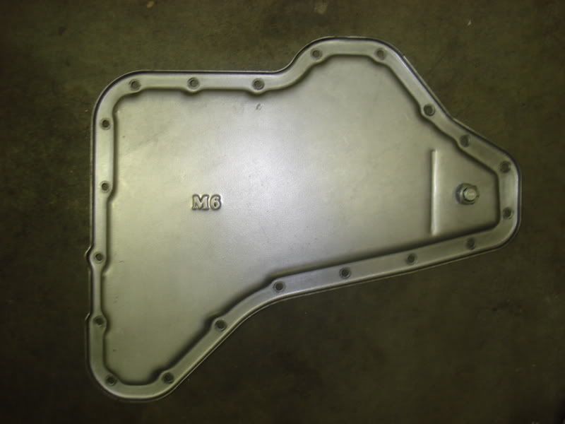

Well, here it is installed. I had to place the drain plug in the same area as the magnet which is at the far right hand side of the pan (passenger side of car). Just drilled a 1/2" inch hole through the pan and magnet. Really no other place to put it since the accumulator, lines and screen filter take up most of the space.
At least the magnet won't be going anywhere.

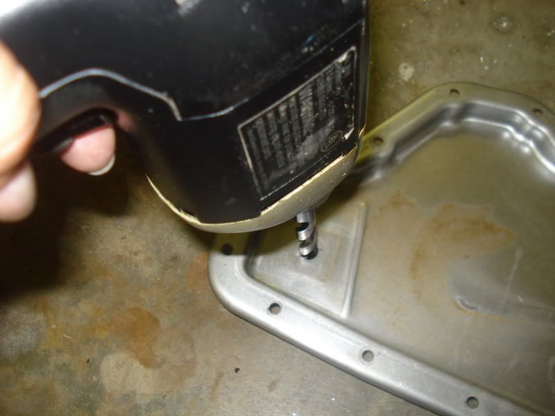

You're welcome. I've got plenty of pics documenting the job. Here is one where you drill the 1/2" hole. I had to go out and purchase the 1/2" drill bit since I didn't have any that size. Black & Decker running about $10 at WallyMart. Easy job overall.

It Is Difficult To Discern From The Photographs, I Can Only Assume The Nylon Gasket Inside The Pan Is Between The Bottom Side Of The Magnet And The Interior Side Pan For The Porper Seal. Am I Correct In This Assumption?

Not a problem. Hard to tell by the pic since the resolution is reduced for posting. The magnet is in it's original position directly on the pan. The plastic washer with the drain kit is over the magnet so the magnet is part of the seal in this particular installation. It has a rubberized coating on it and appears to be flexible. Here is another pic below. If you need the full sized image just let me know and I can email it to you as as attachment. So far with 2 days of observation no leaks at the drain plug.
