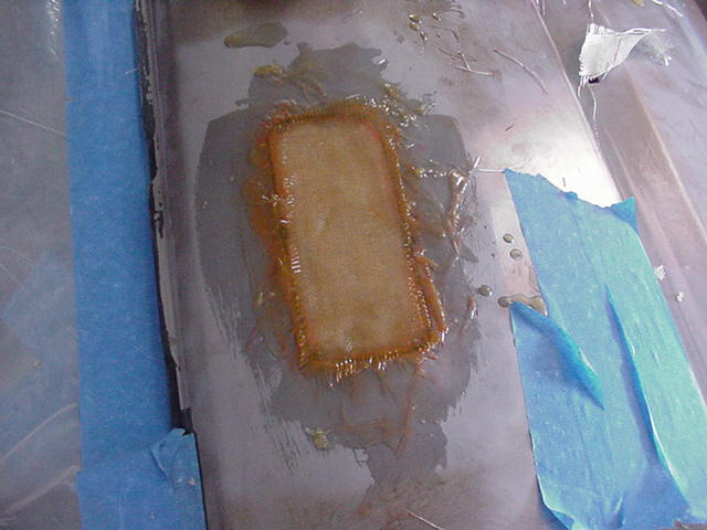

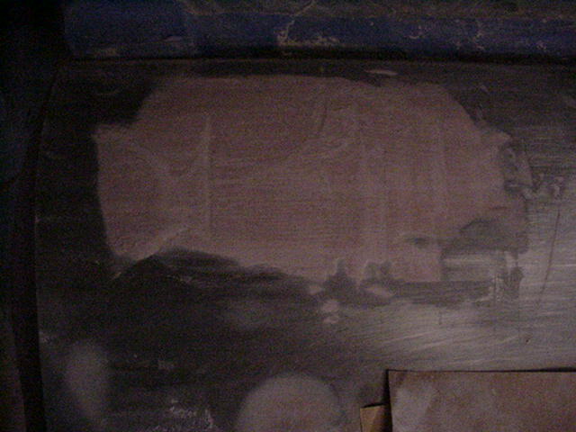

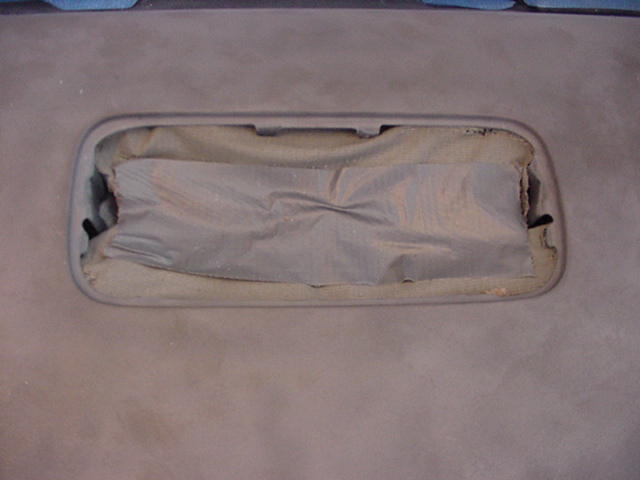

i decides to shave my handles while i had nothing to do...........here are sum pics im al most done with the passenger door ill prolly start the other one soon just taking a brake if i didnt wake up at 1:30 today i might have had both done...........

Looking good man, in the 3rd pic its looks like some kind of resin ober the metal filler plate and I was wondering how you do that. What it is, etc... I want to get my handles shaved and wanted to know what they do exactly, any info would be greatly appreciated.

i just cut out a piece of sheet metal, and tack welded it on then just fiberglassed on top of that....sand it down till you can see the outline of the hole, then i bondoed over that sand it out nice and smooth and paint it..........i have to do alittle more sanding tomorrow and they will be done but im not goign to paint the car till around augest.......

You got some talent man, good work. So if done correctly it wouldnt ever crack or anything, the fiberglass resin sticks to the metal good, etc......

this is what you need:
1 sheet metal
2 fiberglass and the fiberglass cloth shit
3 sandpaper (like 80 grit)
4 bondo (about 120 grit sandpaper)
5 take your time to get it perfect
after that you would need the door popers and a way to get in the car
