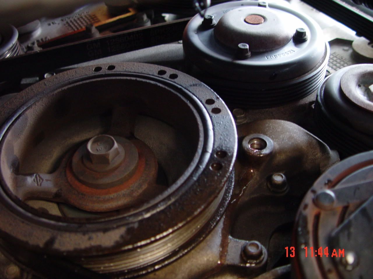

I changed my coolant today and I was able to swap-out about 8 liters (1 gallon antifreeze/1 gallon distilled water) of coolant (should be 10L). I found the engine drain valve and it's a hex 3/16 or 5-6mm metric hex-key (allen) type bolt. You had to move (not necessarily take off) a piece of plastic (3 plastic expansion screws) from the bottom of car to get room. I used a stubby ratchet and adaptor that will take hex bits.
That left-side drain plug was a pain to get loose. I jammed a flat head impact screwdriver bit (bigger than standard hex bits) into it and was able to get it to move with a ratchet (a pliers wouldn't get it to move). It moved fine after that, didn't come out but was able to drain the coolant. The coolant drains thru the existing body hardware=you will see what I mean. The air-bleeder valve will bleed to the outside of the car = this may surprise you = if you look closely you will see the opening. I thought it just let air out of the air bleed screw itself = it's actually a valve, the opening is 90 degrees from the screw.
I took the front air-dam off (5 10mm metric bolts), I'm not sure if this was necessary or not.
