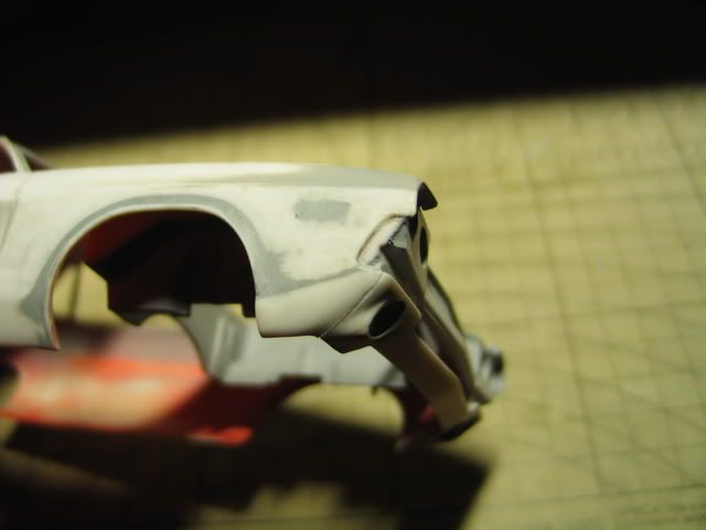

- cut out the rear of the body for the R/T exhausts,

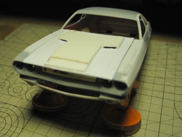

- new, R/T kinda hood, based on the spare hood of the original kit,

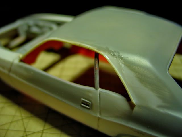

- I had to make new window trims because I sanded off a piece of original ones,

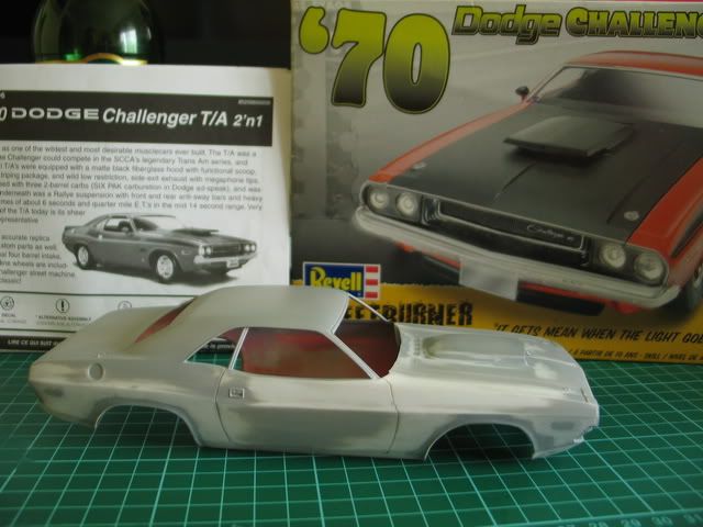

Original T/A hood before customization:

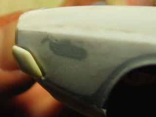

Filling of the gaps on the fenders:
I started to dislike custom version because of this picture.
Making of a new window trim out of a two layers of 0,3mm styrene strips:

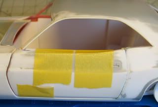

New panel line:

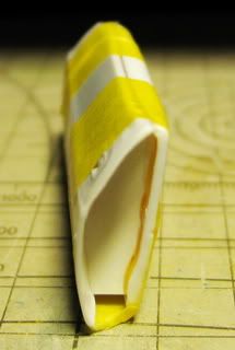

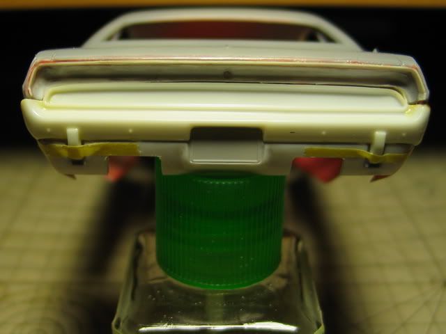

Bumpers didn't fit properly so i had to put them close to the fire.

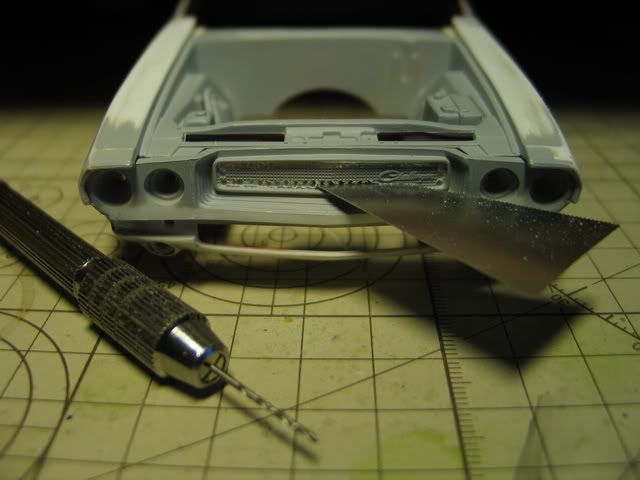

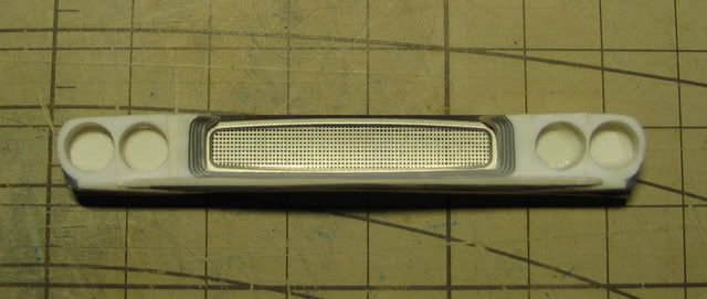

Cut out grill:

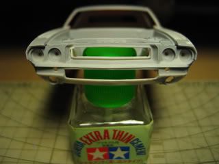

Shortening distance between lights:

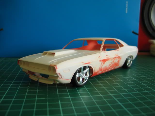

Engine R/T hood WIP:

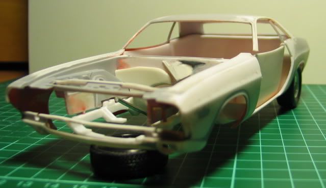

Current state:

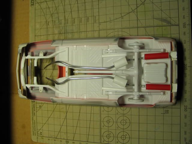

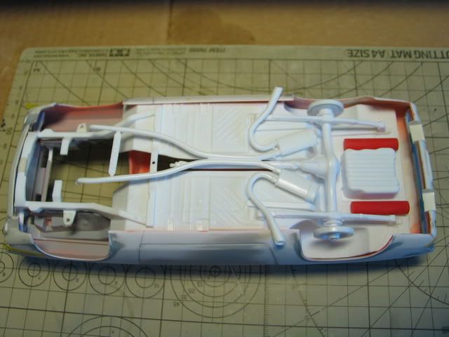

I was working on the exhaust during past weekend and got carried
away with work on Challenger because of the bad weather (floods) in my country.
I used Italeri's excess plastics from 1/9 street Desmosedici for silencers:
Original exhaust for T/A version:
Modifiied R/T exhaust where I used 2mm aluminium tube for pipes:
You'll notice that there are smaller mufflers on the previous pic. I had to remake
them because they weren't big enough.
While I was working on the exhaust I also did some work on the front and

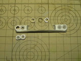

so the mask got it's almost final image. I just have to modify edge of the rings
to thin them and it'll look just fine. Lights are from Michal.
I cut off back of the lights and drilled through the existing hole to fit in the rings easier.
...mock-up of the lights - amazing stuff, this PE lights with lense.

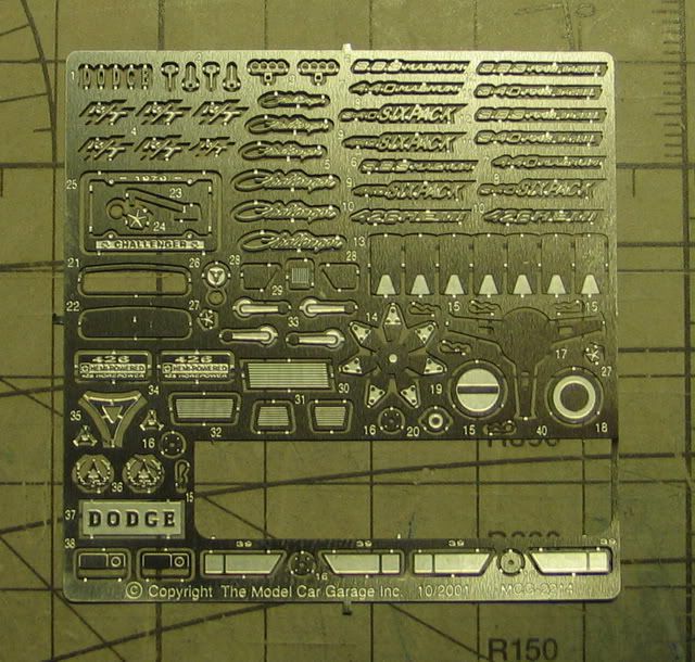

MCG Challenger PE detail set:

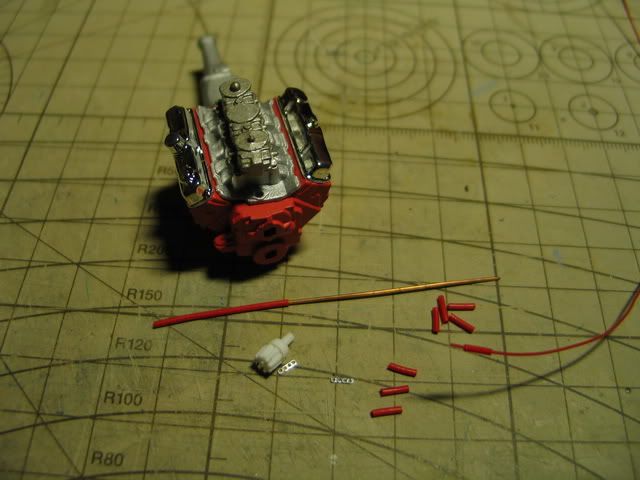

- cut out the original battery, made a new platform for it and scratchbuilt a new battery
Work on the engine's mainfold (Edelbrock Air Gap RPM) and some electronics, distributor cap and wiper motor:

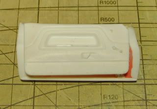

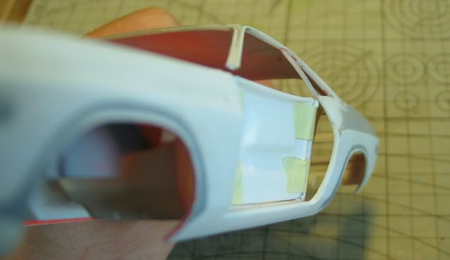

Olfa cutter, glue and some styrene came in handy at the preparation for movable door:
Reference pic (from: http://www.521restorations.com/index...0Jamb%20Pillar
and http://www.pro-touring.com/forum/sho...t=36864&page=2)
That's it for now - I hope I'll finish driver's door very soon because there is still a lot of work ahead of me. Thanks for watching!

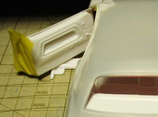

Posts: 128
Re: Dodge Challenger T/A -> R/T "Vanishing Point"
Thanks for your comments, guys! Still nothing from Revell, Brady - I'm checking my mailbox daily.
It should take a while for the parts to arrive because they explained (...in the last mail I received) they'll need 2-3 weeks to process.
I don't care how long it'll take them to make me happy because there is a long journey with Challenger ahead of me...

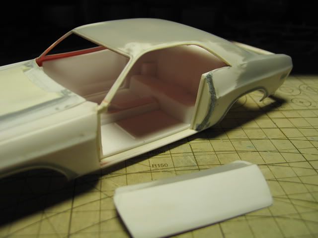

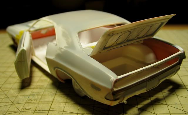

After filling the driver's doors with epoxy putty I did some work on the interior and the trunk compartment.
While I was searching for reference pics I realized there is something wrong with the seats... After two hours of "research"
I realised that Revell used '70 Cuda seats for Challenger kit instead of these. Modifiying over and over again - I'm not complaining because
I like to work with Revell but it's certainly not going to be a "reasonably quick" build.
OK, enough of words and let pics do the talking:
Milled out the original carpets:

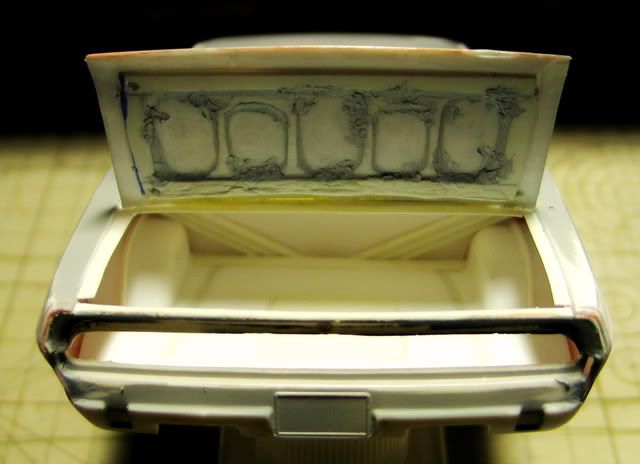

Trunk before:
...and after - there are still some details (hinges and a few pieces of styrene to add) to be made and I also have to sand/fill the cover of it.
The real 1970 Challenger trunk:
stormer_GS is offline   Reply With Quote
