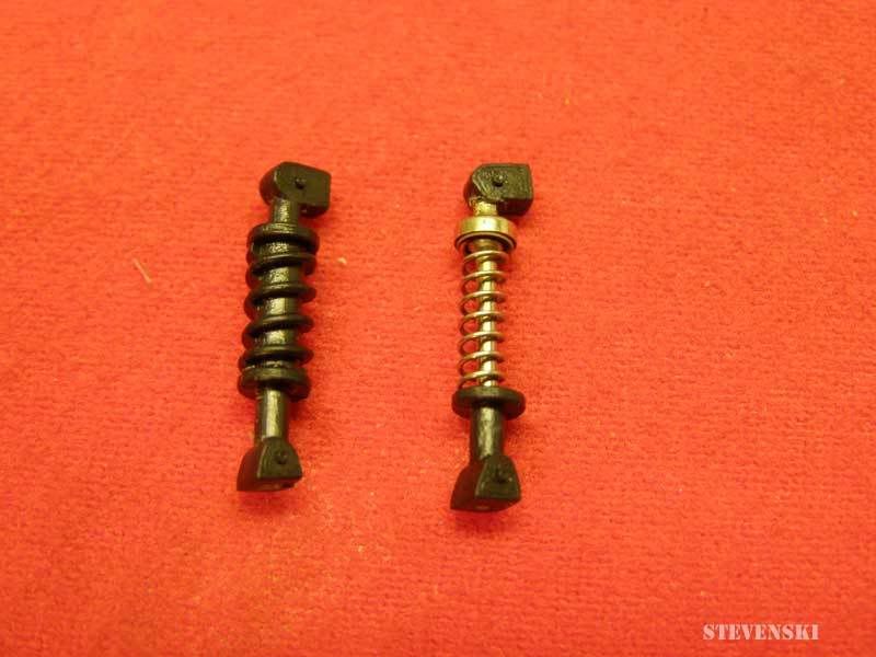

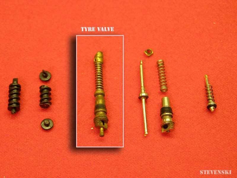

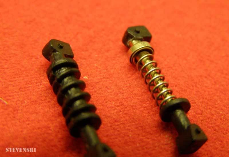

How would you feel about a different take on tire valves in scale models?
This is the Klutz perspective: Why try and reproduce them in 1/24 scale when you can just slap 1/1 full-sized tire valves into your kit?
I'll let the pictures do the talking for a change.
Enjoy
who needs a lathe anyway...?

I do.......!
Wonderfull idea, my dear friend Steve!
Nice the shocks.
I like it.

that's a brilliant idea, steve. i know a few people deserving of "donating" some valve stems to my project.

Re: Converting the BMW M1 Protour into a Ferrari Daytona 365 GTB/4 LeMans
Hi Steve,
as mentioned in the mail earlier: great stuff - a modeller has to keep his eyes always open for useable stuff ;-))

Great tip!
The shocks look great.

Steven,
Amazing job with seat, trumpets and shocks! Waiting for more...

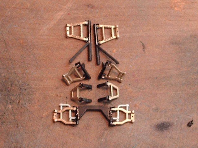

here are the A-arms; i've since touched up the paint so it all matches. the arms are Tamiya titanium gold, as per my references.
i mounted the rear lower arms and -- guess what? -- there were huge gaps. (italeri kits don't have the best fit. ) so i had to do some more putty and paint; once everything dries, i'll touch it up and finish the chassis.

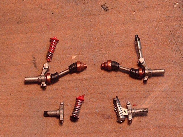

i tried scratch-building some shocks; they didn't turn out nearly as well as ski's 1:1 valve stem idea. there's a kid who likes thumping his bass-heavy rap at ungodly decibels just outside my apartment, so he might just donate some valve stems to the next project. you can also see the italeri molded the front shocks to the upright . i cut the shock off and scratched a new one with brass rod, copper tube and wire. yes, i know the springs aren't quite even.

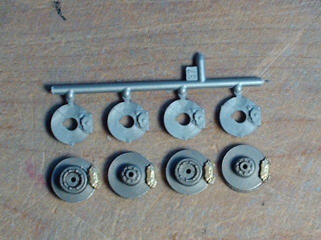

the italeri wheels and brakes are sh!te - italeri used the same molds for both the 365 and the 288 GTO (and god knows what else). stryfe101 gets mad props for donating a full set of brakes, wheels and tires from a Fujimi Enthusiast 365 kit. they look 1,000 times better, especially after detailing, a wash and Studio 27 PE. they look great in person; my camera couldn't catch the detail. i'm really pleased with them. too bad they'll be covered by the wheels.

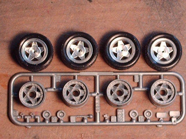

the wheels from the Fujimi kit are, in a word, gorgeous. a vast improvement over the italeri kit pieces. the Pozzi cars ran gold wheels, so i'll be painting them soon. i'm using the tires from the italeri kit, as they're lower profile and wider than the Fujimis and look racier.

All right, I don't know how I've missed posting in this one for over a month now.... Two fun projects for the price of one! (I'm glad to see that 365 found a good home!)
Stevenski my friend, I always enjoy watching you detail a build. You never cease to surprise with new and resourcefull ideas- that manage to work!

Next time you wind springs, here's the technique I use: I cut three lengths of winding wire, and wind them each around a suitable diameter piece of telescoping brass or aluminum tubing, so there's no space between them. Then pick one of them and carefully unwind it from the tube, leaving the other two undisturbed. Slide the remaining two off of the tubing, and carefully untwist them from each other. Done right it gives you two coils, with consistent and correct spacing. Maybe I'll do a how to, but hopefully my description makes sence.

Looking good CeeElle. Those A-arms etc. on the Italeri kit look just as well molded as the Fujimi Enthu stuff but that's really cool of someone to donate the brakes and stuff
As your partner in crime I feel I have the right to say.......do them again!! Don't accept 2nd best on that
