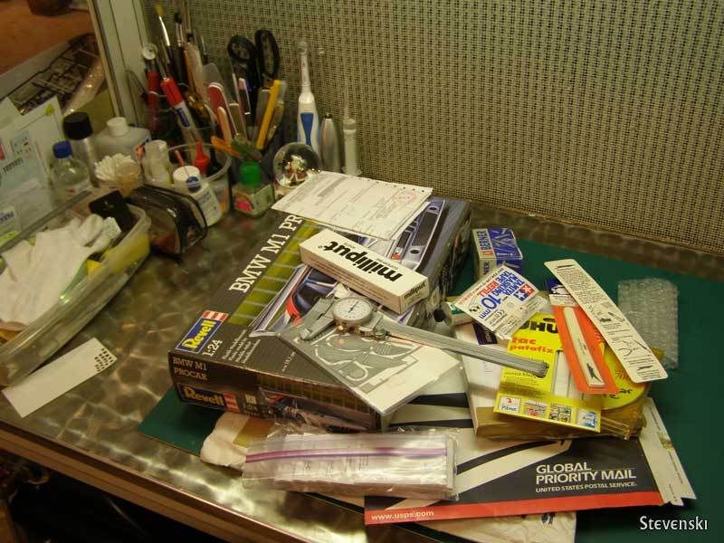

OK smart a$$
This is my work bench as of 10 minutes ago.
The Prisoner Super 7 has been cleared off into boxes waiting for the ver. 2.1 rim, it's been cleaned down and I am now officially putting the "W" and "P" into my WIP

Best part about modeling - not just getting new kits, but when the delivery guy drops of tons of goodies to add to the mass amounts of money already spent, lol.

boy are you a slob.

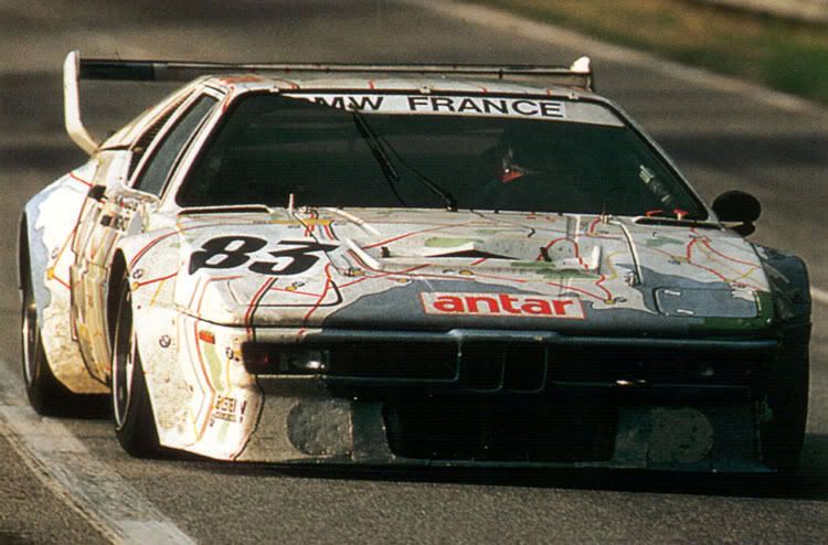

I don´t whether I told you in my mails about the "Map of France"-M1. Just to make sure. I advise you to think twice where to put the borders between the white and blue paint job since the decals are kind of transparent. To show you what I mean I just include a pic of my M1 where you can see through the map-decals and see, where I chose to border the white and blue paint.
But I´m sure you thought about that already
So have fun with the build...I´m excited to see what you can will make out of this challenging project.

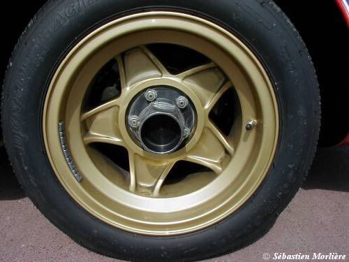

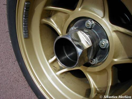

does anyone have a set of brake calipers/rotors and/or wheels/tires from the Fujimi 365 enthusiast kit they'd be willing to part with? the pieces in the Italeri kit are sh!te... if you can help, please PM me.
these are the wheels on the pozzi cars, and the Fujimis probably come closer than the Italeris.:

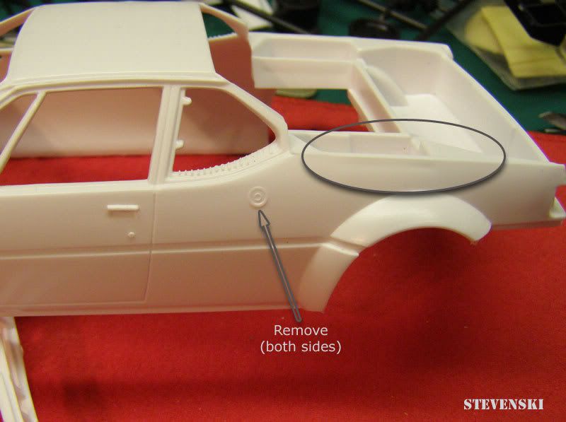

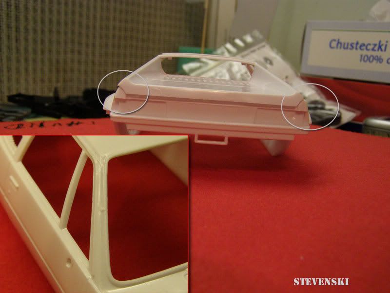

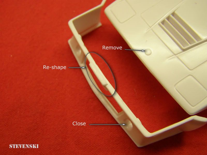

This is with out doubt the worst fitting and molded kit I have ever had my hands on except for the Monogram Lotus Esprit. Here are just a few of the things I'll need to do to the body in addition to adding the trans-kit parts.
The BMW "kidney" grille more resembled a BMW "squashed tomato" grille!! It was totally misshaped On this photo I have already reshaped it with a sanding stick to get it straight enough to fit it to the body
Bits to remove and sink marks to be filled...
Bad fits and "glunky" molding...

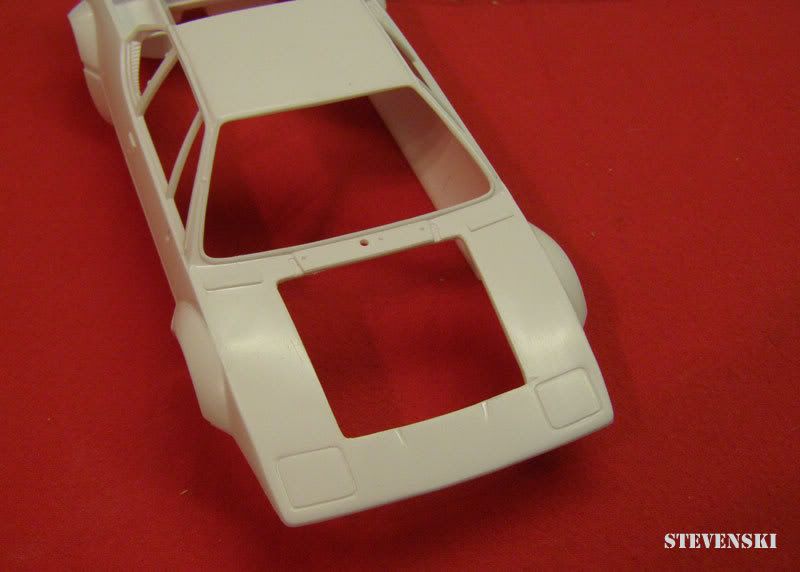

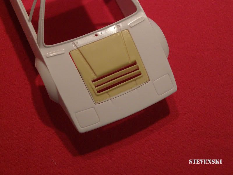

After removing the flash and general sanding to fit, the first "real" work was to remove the kit hood to replace it with the Renaissance trans-kit part.
I drilled out the four corners and joined the dots with my trusty Hasegawa p/e saws (they have really useful shapes and cut sizes)

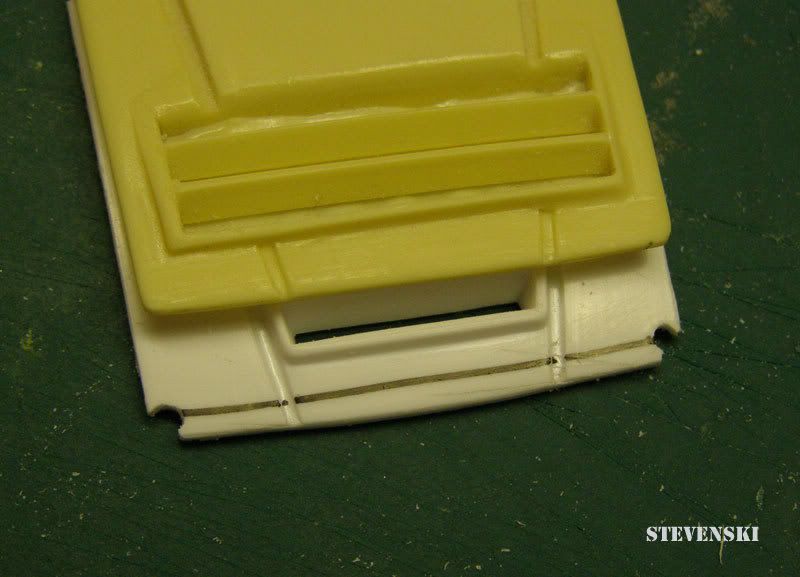

Done....and then I found confirmed what you all knew already - I am a complete imbecile!! I just assumed that the Renaissance part would be an exact fit to the kit part. Doh!
...and I was so pleased with myself at so cleanly cutting out the Revell hood
Lesson learned - I should have put the new part to the kit and outlined around it.

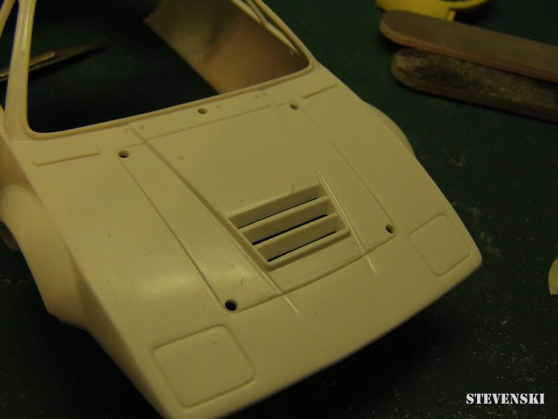

I fixed it by cutting off the missing part from the kit, adding styren strips around the edges and a few rounds of putty/sandstick.

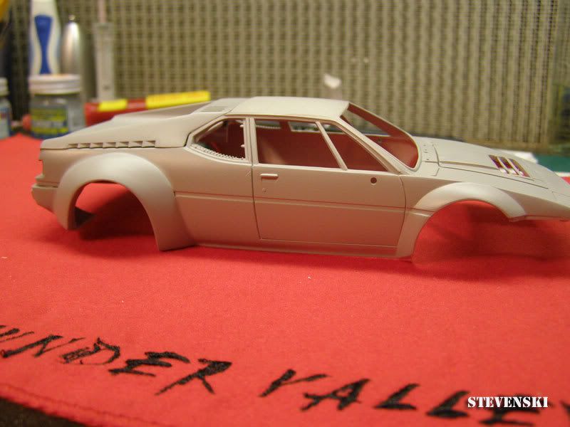

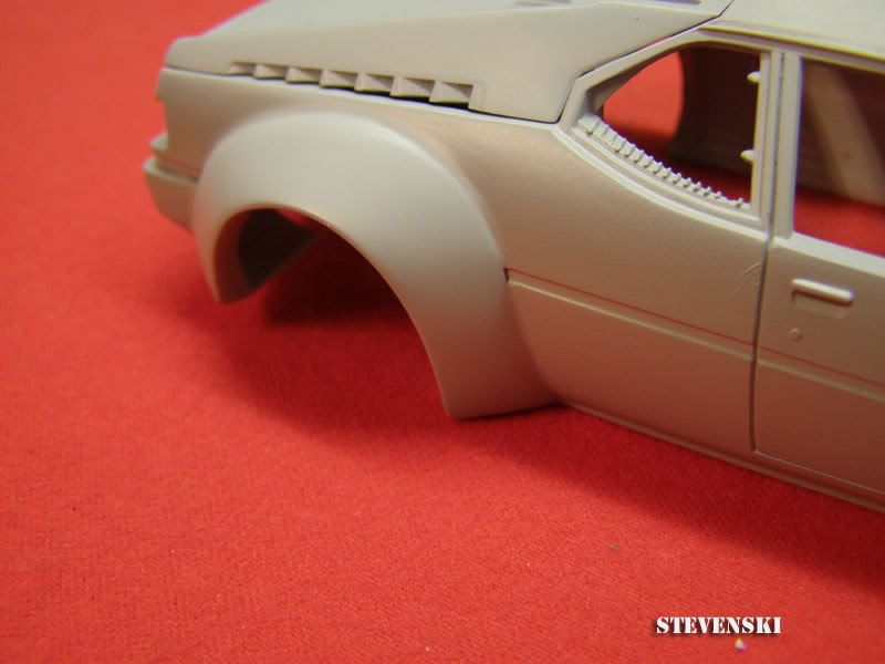

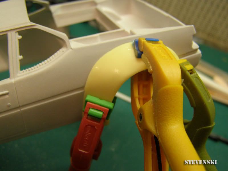

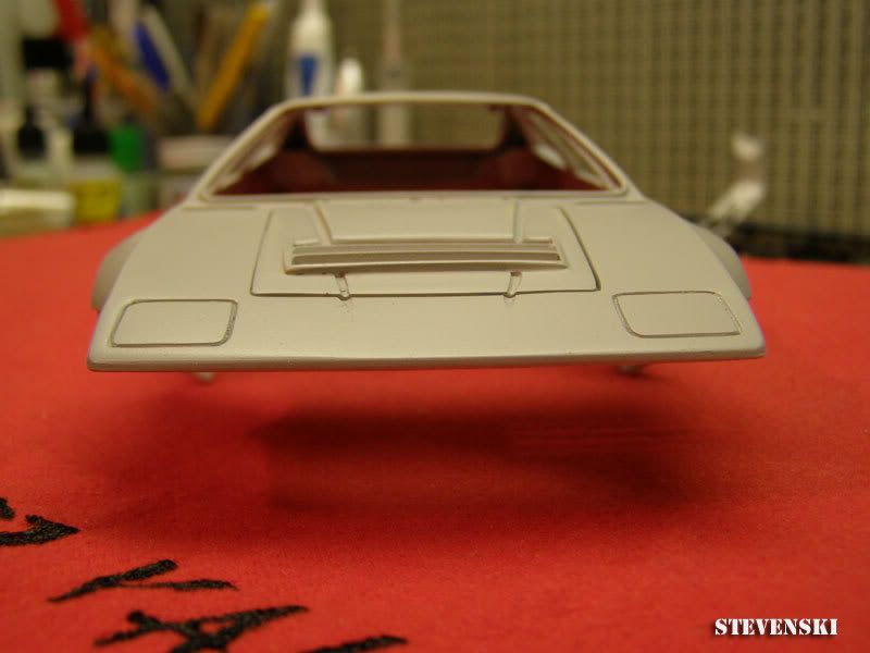

Glued the wheel arches on with 5-minute epoxy..
2,5 days of putty, sanding, primer (ad nauseum) and I am getting close to finished. Still a few eye-sores to be fixed...
uff!!
Uff!! Proof that I really have started.
Thanks for looking and over to CeeElle...
