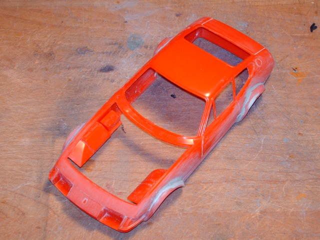

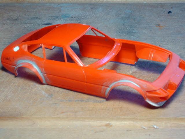

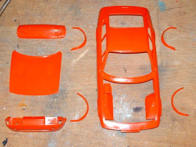

i've started assembling the body. the fit of the flares is, in a word, sh!te - huge gaps that needed filling with Tamiya epoxy putty from the underside and modelling putty from above. still a little work to be done there.
there were also some gaps where the front end fascia joins the body; i filled those with 5-minute epoxy and will smooth them out with putty.
i shaved the ferrari emblem on the trunk lid (boot lid to people on ski's side of the pond ) and the door buttons/handles. i'll use a Crazy Modeler (what a great name! ) script on the trunk. i don't see any external door buttons/handles on my reference pix but must do more research before knowing for sure ... i've also gotta open up the fuel filler, where i'll install a Replicas and Minatures of Maryland resin fuel filler cap, and open the front grill, where the molded-in faux-mesh will be replaced by MFH mesh. i've also got some white metal lights somewhere in the parts box for the numbers on the doors.

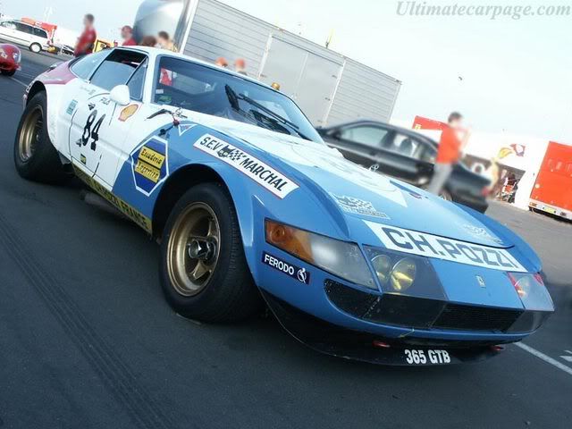

here's another shot of what we're after.
if anyone's got interior or suspension detail shots of the Pozzi car, i'd love to have 'em.

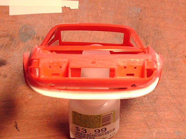

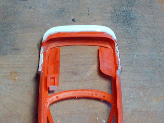

small update. added the chin spoiler, made the fuel filler cut-out and did some more body prep.
chin spoiler, made from three pieces of .010 styrene. i used a carpentry contour gauge to get the shape of the front fasia, transferred that to a shieet of .010 styrene and cut it out. then i glued that to another piece of styrene and used that as a template. once i had a rough shape in .020 sytrene, i folded it in half and filed it to shape so it would be symmetrical. once i was happy with the shape, i glued it to a third piece of .010 styrene, cut it to shape, sanded it and glued it to the body with CA, followed by 5 minute epoxy for strength.
from the front (i also cut out the molded-in grille mesh. the shadow and angle of photo make it appear the spoiler is lopsided. it's not. ):
from the bottom (the small square of styrene on the fenderwell is the side of the battery; italeri figured a three-sided battery was accurate. ):
from the side (note the cutout for the fuel filler):
the fuel filler is recessed on the 1:1 car:
i cut out the fuel filler using a bit and round file, then notched it on either side with a square file. a small square of .010 styrene was then glued to the back side.
next up -- more filler and sanding before laying on some primer.
thanks for looking!
