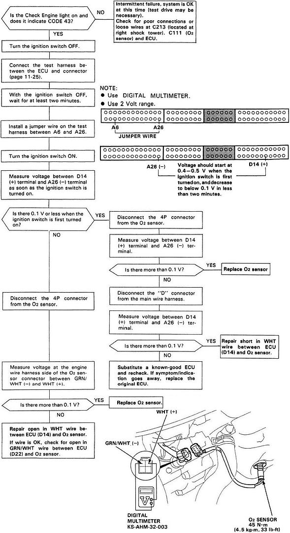

ECU Code - 1
I have been having an issue with stalling. And got an Idea to check my ECU for a code. when I turned the car on I got one red blink, I checked online and it says that its a oxygen content ... what ever that means... I have 2 questions one - what does that mean and 2 - and how do I reset my ECU codes.. (I just want to make sure that thats the only issue that im having and I dont know how long its been getting that code..)

It's your O2 sensor, probably gone bad.
To reset, unplug the negative wire from your battery terminal for a few minutes (you'll lose the time if you have a clock and lose your preset stations on your radio).

unplug battery to reset. if it comes back on. test o2 sensor. replace if needed.

ok, thanks I will do that... just one more question.. How do I test to O2 Sensor.

To test it you... should buy or download a manual for your car I couldn't find any links to them online, so here's a screen cap of it: http://img.photobucket.com/albums/v4...icSpoon/O2.jpg
I know it says code 43, but I just skipped the short part of the code 1 and it took me here (for file size sake).

the O2 sensor. is in the exaust manifold right?

Yeah, either the front of it or at the back before it meets the cat, depending on what motor you have. The CX and VX have the O2 right in the front, because of the way the cat is attached to the manifold.

d16z6 is also in the front. as for any newer car (obd2, 96-up) there will be 2 one in the front like mentioned above and also in the cat.
i am surprised your car is stalling from it though, it shouldnt i am thinking something else would cause that, maybe the oxygen sensor code was there before.

if O2 is messed up, your ecu will go into default mode and so your car should still run fine even if your O2 sensor is fucked up. could be some other screw up sensors causing your engine to stall.
