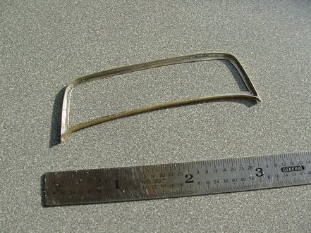

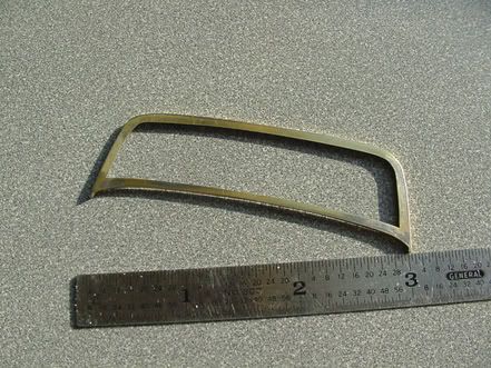

Windshield/Rearview Mirror parts
Made these so far...
The windshield frame is fabricated from sheet brass and soldered together, with brass tubing for the wiper fairings.
The wiper/arms are also brass with some machined aluminum details.
The rest are machined aluminum parts.
The Wink mirror has an anti-glare coating on the panels, I still have to finish the housing.
The side view mirrors have different faces, wide angle for the passenger side, standard for the driver's.
Still another dozen or two parts to make for this assembly, but at least I can start painting and decaling some of it now... - Mark
Here's a couple shots of the basic beginnings of the windshield frame.
