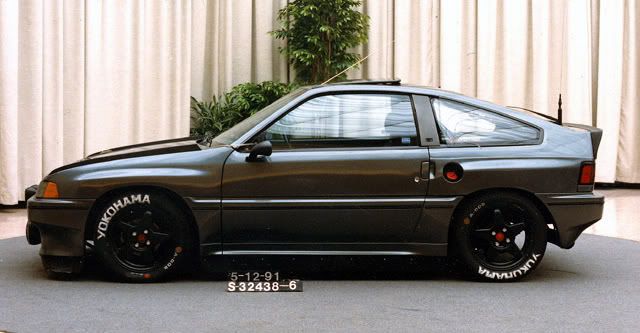

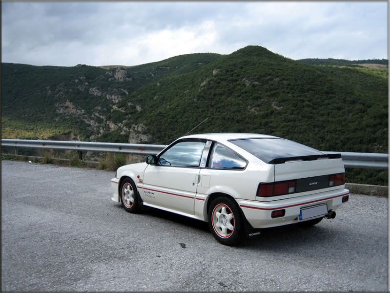

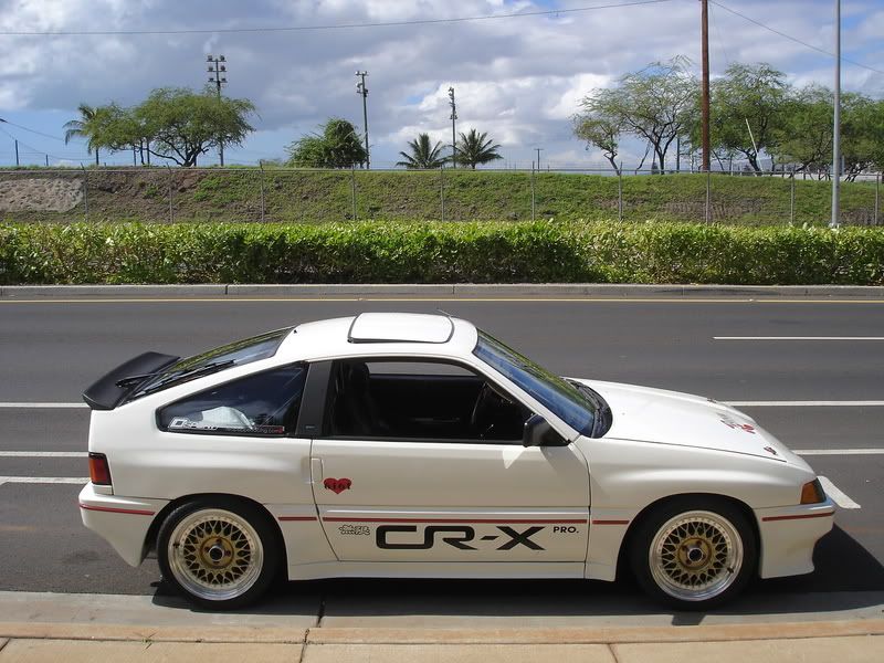

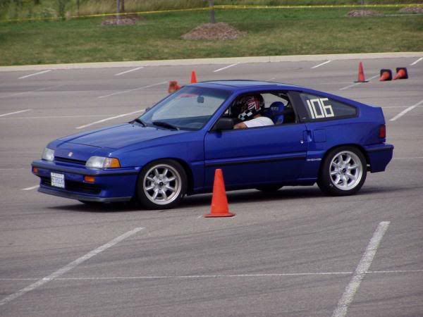

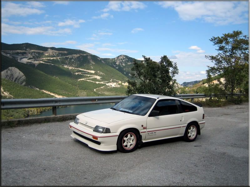

i love old hondas...
some ideas..

Thanks for the examples Evil Hanzel, I like the white one with the flared arches it looks like the old kit of the Mugen version Tamiya made a long time ago! I will probably go for a Honda Milano red colour with gun metal wheels for mine!
