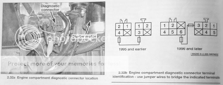

Here is a picture of pin connector to get codes and location.
Turn ingition switch to off, disconect pin connector.
Turn ignition switch to run position and hook up jumper wire to indicated pins for 2 seconds no more no less and disconnect jumper wire.
Check engine light will flash example 1 fash pause 2 flashes = 12
Codes will continue to flash so you do not have to hurry to get them read.
Where? Is it under the passenger side kickpanel?

In the engine compartment, driver side. Look just above the starter to the left (towards passenger side) connector should be there. Use the picture with the connector pins for a reference.

Hopefully this works:
http://i644.photobucket.com/albums/u...cconnector.jpg
I tried getting picture bigger but did not work using photobucket so use the link.
If anyone can help me as to how to post larger picture that would be great. Send me a PM with instructions. Thanks
