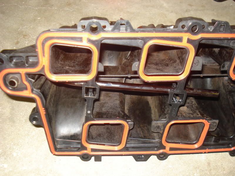

what is that little black plastic tube thingy used for thats clips into the middle of the gasket, its shaped like a J, i took it off and cant remember which way it was facing,lol, thanks joe

That is the tube for the PCV system. The J part goes into the hole located on the UIM towards the PCV and Map sensor (right side). Make sure it is properly inserted into the two retainers on the UIM gasket frame.
See pic below.
