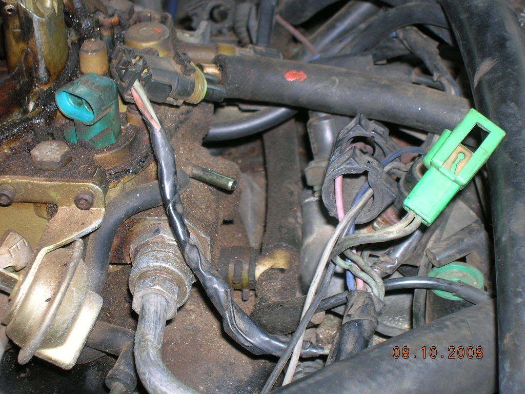

in the pic, does anyone know what the Green plug attaches to? What youre looking at is the area directly in front of the carb, from the passenger side. You can see the choke to the left of the picture. also why does the car die when i plug in the electric choke?
i guess i should mention its an 85, with the 305, and AC.

That is a diagnostic plug, it connects to NOTHING except a dwell meter when you're adjusting the idle air bleed on the carb.
