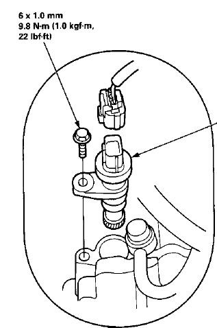

The VSS looks like this...
Also I said below the distributor...forgot you've got shift solenoids in that area...don't mess with them...
Trying to find out more about an input speed sensor on yours...
