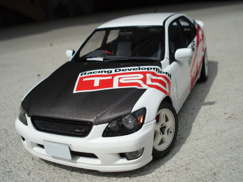

TRD Altezza
Fujimi kit "TRD Altezza Super Street"
Painted with mitsubishi W83 white.
Mods:
-TRD front lip spoiler
-TRD aero grill (badge made from 5 minute epoxy over decal over styrene card, opened and meshed)
-TRD T3 wheels
-Front bumper makeover (filled gaps with fender, opened all holes, fog lights from tamiya celica, closed headlight opening for fitment of lenses, even the hood was involved)
-SMS carbon decal hood
-side markers from tamiya celica
-TRD muffler with machined aluminum tip
-lowered, front/rear camber adjusted, rear toe out adjusted
-TRD front brake calipers, front/rear slotted discs
-TRD seats
-chromed shift knob
Thanks for looking!

I lowered the front using the same method from here:
http://cmmt.netfirms.com/cgi-bin/top...c=2518&show=25
basically just cut off a section of the strut and insert a rod (paper clip, plastic rods, anything works really) in to work as a mounting point. Chopping the top of the struts away will even save this step as there are no reconnections necessary.
The rear suspension did not actually get a lowering job, but rather a camber change. Changing the camber of the rear wheels were enough to also give them the effect of being lowered. I just put a very small piece of 0.25mm styrene card between the wheel hub and where the multilinks meet (at that point, keep the styrene card at the bottom half of the connection otherwise you might end up with positive camber)
evil_hanzel: Yea the wheels does look a little bit small, perhaps it is made that way so they could reuse their decades old tires?
