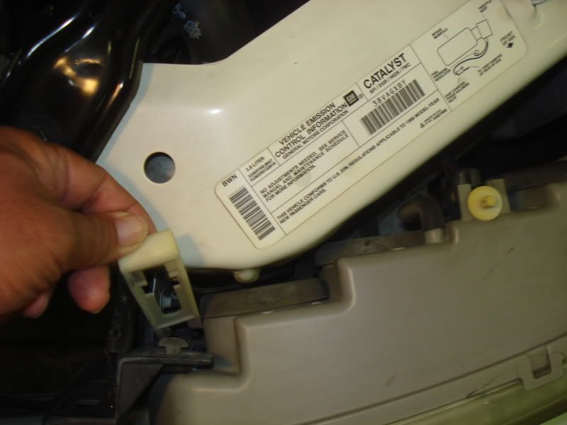

I don't see the clips you are referring to.....if i'm looking over at the back of the assembly where should they be?

See pic below.

Thank you....... worked like charm.... just couldn't see where it released from until your pic... again appreciate help.
