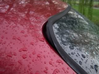

DnaProRacing, Did you have to "reseal back window = $136" because water was getting into the cabin and/or trunk? I have this problem and was wondering if the rear window is a probable culprit. Here's a pic of mine:

Re: What is your Cars history?
yeah it was leaking where the brake light was. i actually tried sealing it myself but it ended up looking like shhtuff. so i took it to a specialist who put it in for $136 and it looks great/no leaks. took them about 20 mins. oh, they have to order the seal for it. its 40 bucks for that alone.

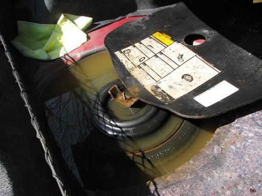

where was yours leaking to (floor, trunk, etc)? Mine, unfortunately is leaking into both. With all the rain we've had in the midwest recently, it's not been fun getting the water out. As you can see from my photo above, the seal has peeled quite far away from the car. I've been told [on AF], however, that this is not the cause of my leaks. Either way, here are photos of my water-logged lumi:
that was over 8 gallons of water in the trunk...nice, huh?

maybe the seal on the back of the truck lid? and yes that is pulled out quite a ways. i'd be surprised if that isnt leaking too. oh, and mine was leaking onto the speakers in the back. nowhere else...

cool thanks! I guess I'll get someone I really trust to hose down the car while I'm inside the trunk with a flashlight, as I've been told is the only way to really pinpoint the problem. I'm just not looking forward to doing it; although it'd be better than trying to remove literally buckets of water Although I've been told that the rear window seal is not going to be the culprit, I think it could be because the water could get in there and go into the back floorboard and into the trunk. It's just right inbetween both. Well thanks for your assistance
