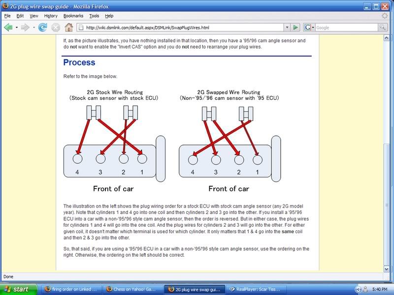

firing order on Linked '99
ok, so i cant get my 99 to fire up, i changed the computer today, to the linked 95 eprom (i was told it was in working order uppon purchase and it better sure as hell be!) i swapped 4 with 3, and 1 with 2, and the car just cranks, the DSMlink chip is burned for 950cc fic injectors, which are installed on the car... all lights on the dash work, and it turns over, but no firing... just keeps cranking, i have fuel pressure, but not sure about the injectors (i'm sure they are giving fuel they are brand spanking new!) then i put the plugs back to the oem place thinking maybe, just maybe for some reason mine wouldnt be switched... nothing happened... can someone explain to me from the cam side of the block, the order the plugs need to be hooked up!?!?!

|I got ya covered bud

thanks buddy! no wonder why it wouldn't fire up! you just saved me from buying a new eprom computer... thanks $300 worth!

ok just changed the wires and still not starting! i'm really starting to get mad! today is my only day off this week and the only day i have time to work on my DSM... WTF next? anyone? it just cranks and cranks, if the ECU was bad, how would i know?
