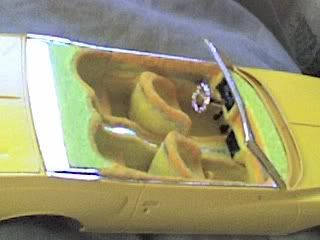

I used that microscale product last night and the night before. IMO it works very well. When you compare it to Elmer's glue the thickness of the glue is very noticable. Elmer's is very thick (think honey for pancakes and french toast Yum Yum) and Microscale is very watery like which is easy to brush and spread around the foil. It's white but when it dries it turns clear. Last night the thought of using it to glue clear parts crossed my mind. It is very sticky but yet, if you are careful, you can still peel it off to make corrections. You also have to watch out how much you brush onto the foil. Too much of this adhesive gathered in one area can be noticable when you apply the foil. For example, last night I brushed some on and small puddles of the adhesive gathered on some parts of the foil. It dried, cleared and I thought went away; however, when I applied the foil I noticed the bumps where the adhesive had gathered and dried. So to avoid this you'd have to brush small, even amounts and make sure puddles dont gather. Ill try to post what I did these past two days but please be easy on the comments of the picture quality cause im going to try doing this with my cellphone camera.

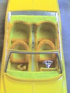

I did the edges and trim of the car using Microscale to give the foil more adhesive.

^^I cant see the pics, thx for your advice anyhow.

How about now?
