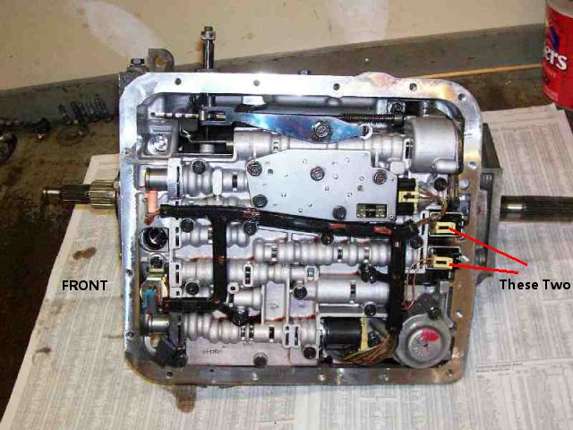

The following picture was unceremoniously stolen from Blue Bowtie, resized and remarked for your viewing pleasure -
The arrows point to the two solenoids. In my case, I banged the connectors with the pan when I was maneuvering the pan past the exhaust crossover pipe.

that is awsome thankyou very much , thats was exactly what happened with mine, after taking the stupid pan off again and using you pic i figerued it out. thank-you very much
