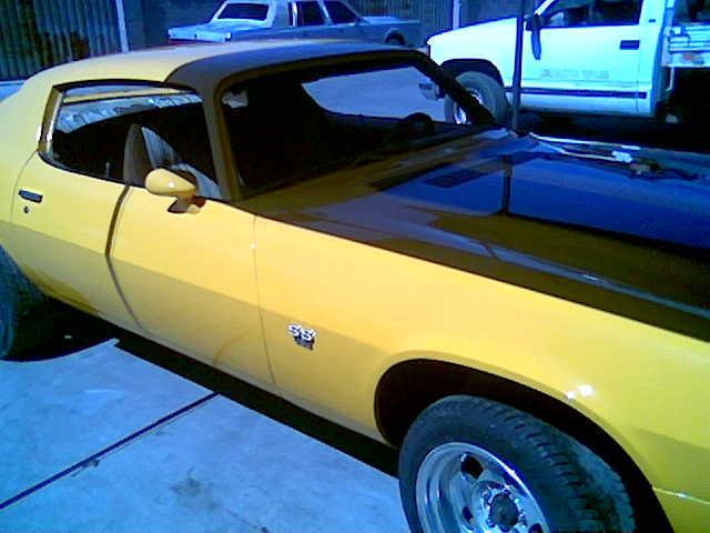

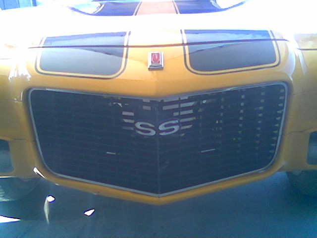

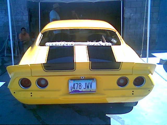

The Camaro: Update
Before-
After-

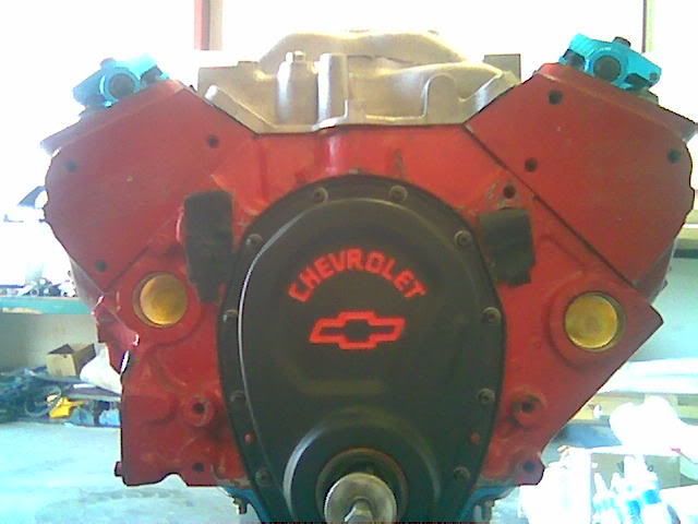

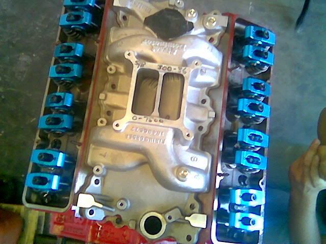

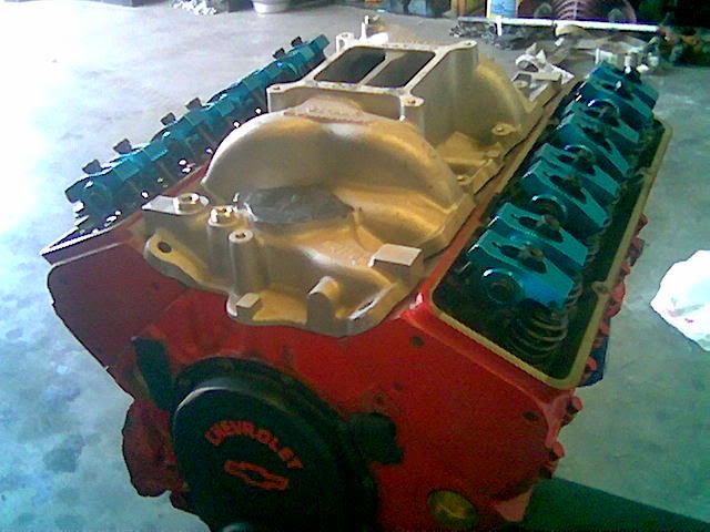

The motor needs a few more bits and it'll be going in next.
Notice the Behives in this one?^
Then finally the interior will be done. I'm hoping to have it running within the year.

About God damn time Aaron.
I'm tired of seeing 1971 Camaro SS 5.7 <-- Under construction in your sig.
Looks good man, diggin the "Bumble Bee" color scheme. Very Transformer of you.

damn, that car is hot.

nice what kind of power are you looking to get

Actually I'd like to think it was very Bulldog of the transformers in thier color scheme. I did infact have this pattern picked out many moons ago when I bought the car.
Oh yeah, just for the record...IT'S STILL UNDER CONSTRUCTION!
Thanks man.

Somewhere between 450-500 bhp I'd hope, my cam is good for it but my heads will starve my cam out a bit from lack of valve sizing and small ports. (2.02/1.60 valves-200cc ports). So we will just have to wait and see what i'll put out.
