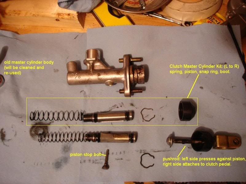

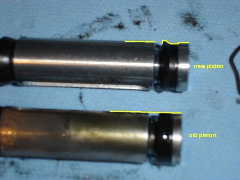

there aren't any gaskets in the clutch master cylinder. its a piston ring (a rubber ring) and a rubber boot that are the sources of leaks.

well gaskets... rings.... i just used a wrong terminology i guess. But they're rubber rings and/or gaskets that hold the fluid inside the cylinder. When I took mine apart I got it all back together in 5 minutes. It's really, really hard to screw up the order in which the parts go.

its so simple, you cannot rebuild it incorrectly. i rebuilt mine b/c 1) it was cheaper, and 2) i could get the rebuild kit at a local auto parts store, rather than having to drive 20 mins to a dealership.
