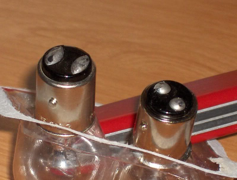

Well, I hope I found the problem. Sorry if the pic is large, but I wanted to the contact points. Notice the deep gouges on both sets of contacts. I've always had a slight issue with my PS parking light. Sometimes it would work and then other times I had to tab the light for it to come on. Usually the light would come one after I was on the road for about 15 mins. I think the first time my fuse blew the light had just come on. I believe this also happened the with the second fuse. The picture shows 2 different brand bulbs with 2 diff wattages. The one on the left is the recommended 21/5w. The one on the right is a 27/8w. That is the one that was always slow to come on. So I pulled the bulbs straightened out the contacts inside the socket and installed 2 proper bulbs. I slapped in a new fuse and went for a drive duplicating the previous incident. The other fuses blew within 5 minutes, but after a 30 min drive with my stereo on........no blown fuse. I'll update in a fews days to determine if this was a real fix.

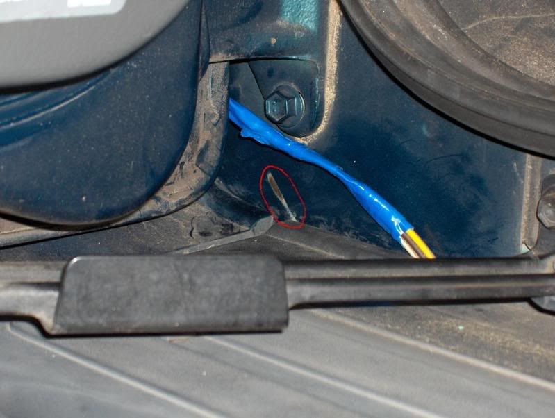

Old 04-25-2007, 08:14 PM   #12
pharm_rodeo
pharm_rodeo's Avatar
Join Date: May 2006
Location: Pharm School
Posts: 241
Re: Keep blowing fuse
Thought I would close out this topic.
The light bulbs were not the fix. The fuse blew again 2 days later. So I tracked down the wiring diagram for that circuit and started poking and prodding to see if it would short. When I got to the rear bumper I saw a set of wires and poked them......the fuse blew. As you can tell in the picture, the paint was actually removed from the body from the shorts.I covered the worn area of the wires with electrical tape for now. I'm glad I didn't have to rip out wires. The wires wouldn't tuck away properly and the gate is not rubbing it.
1994 Acura Integra LS---212K+
1998 Isuzu Rodeo S 3.2L 2WD---176K+
