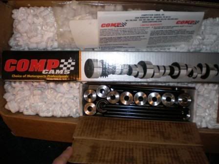

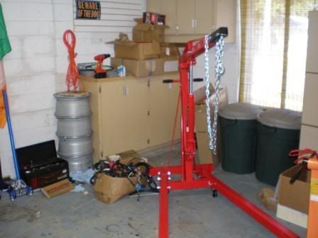

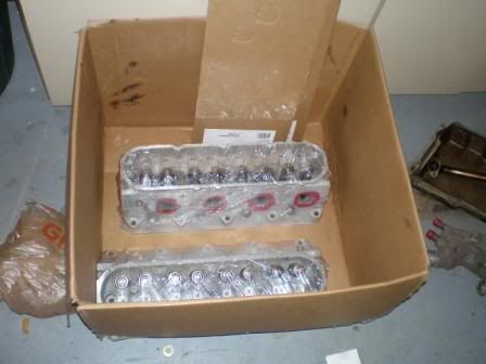

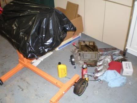

cam isnt actually a comp cam its a TSP 228R. Comp hardened pushrods, manley dual springs with titanium retainers. The motor(i didnt feel like taking the bag off) is a 2003 LQ4 motor and i had the heads milled a little to give a 10.5-1 compression. Then i have arp head bolts and i think im going to pick up some katech rod bolts. Also i got a tsp ported ls6 oil pump for it. I dunno if i should change the lifters or not with only 55000 miles on them, maybe luos can guide me on that. The cam has XER lobes which i understand to be kinda harsh on the lifters. Everything else in the pictures is stuff i have to complete the motor. I need gaskets, seals.....and to decide if i need lifters or not. other than that i have everything so the last ingredient is time. Oh and a 100 shot ...i say that now but ill probably itch for a 150 since these motors will eat it all day. more than likely ill just stick with a 4l60e transmission but stick is sounding pretty good. Also have a jumbo size radiator to wedge in my car sitting in the corner of my garage.

so currently its a 6.0 liter with aluminum heads milled .015, tsp ls6 port oil pump, tsp hardened pushrods, manley dual springs,, ls2 timing chain, and i still dont have a cam....!!!, and some hawks swap long tubes. So now i just need gaskets, a cam, a tuned pcm, and f-body belt accessories. And whatever little odds and end I might need. Then I get to put it all together. Its just going to be a few more paychecks. Cant wait!!
