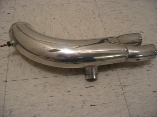

you can either get a flange that has to be welded onto the IC pipe. but if you have the stock rubber/plastic IC hoses, then you may have to opt for one of the DSM BOVs with adapter. OR, if your BOV doesn't require a flange mount, you can simply use a small section of rubber radiator hose and attach both ends with hose clamps.
1st gen DSM BOV with ADAPTER. adapter is on the back.
IC pipe section with BOV adapter welded on.
3SX.com sells a bunch of BOV mounting kits here.
Greddy type-s BOV adapter
HKS weld-on adapter flange
