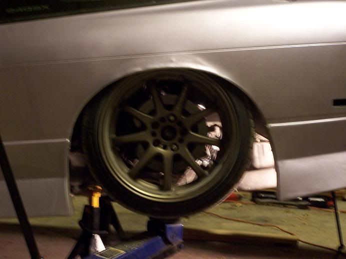

coilovers can still travel plenty, even slammed, its not until u remove the collars or preload your springs does the travel really get sacrificed.. If your buyin quality parts its still gonna have room to compress, sure its not stock travel, but get your panties out of a bunch and realize 9kg/7kg coilovers owns 4kg/3kg lowering springs eight days a week, shit stock springs are like 2.5kg, not a big improvement at all...

if you can find a deal on Z32s, do it, it takes the same time as a brake job and doesnt cost much more... The extra dollars spent are worth it, youll see as soon as you hit the brakes, try it and youll want it... Regardless of power, your still stopping a 2700 lb car, extra braking is better and safer

no travel with coilovers?
R.W.240s car...
KTS Coilovers, full compression...
more than enough travel, if you know how to drive it
