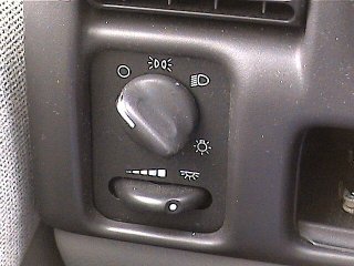

For # 2, I would guess that maybe you have your dimmer wheel (near light switch on the left of the steering column - see below) turned all the way to the right. That would cause the interior lights to stay on all the time. Try moving it back to the left, or in the middle and try again.

About#2, I slided the dimmer to the middle and the interior lights are now off when doors are closed. I thought the dimmer is only to control the brightness of Instrument Panel Cluster. I guess I am wrong. Thanks a lot for your advise !
