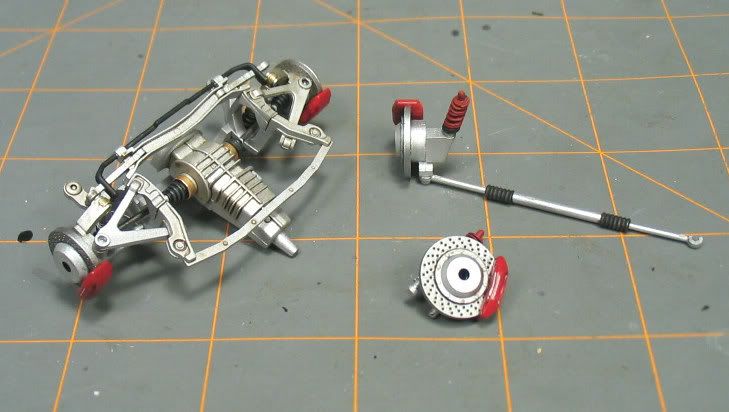

I didn't even take any pics of the body. But I did get some of the chassis.

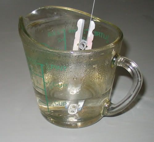

A couple evenings in the freezer finally freed the usable parts from the chassis. And so they wait....
Waiting, waiting...

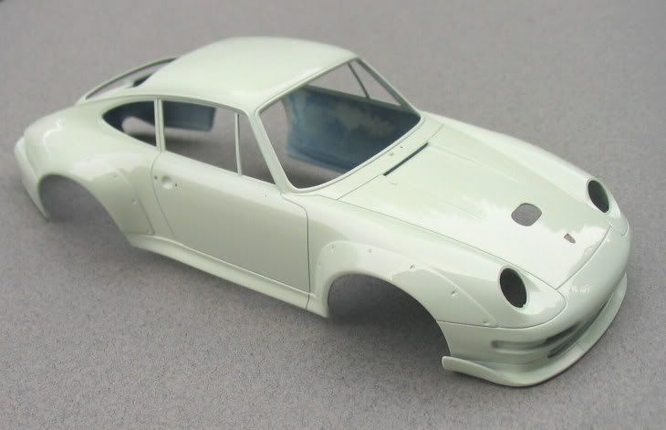

The body at one point spent four months in the alcohol bath stripping- waiting until I could bother to take it out.
But it's out now. Stripped bare of it's former color.

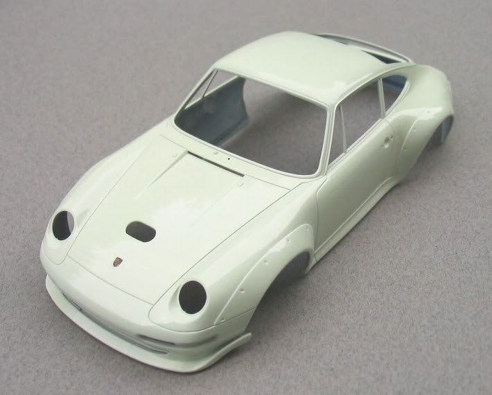

It even has a fresh coat of primer, and new paint now. After months/years of occasional contemplation, I finally concluded that it could look good in white. After all, it looks quite decent that way on the box top! So white it is.
And it's feeling much better now.

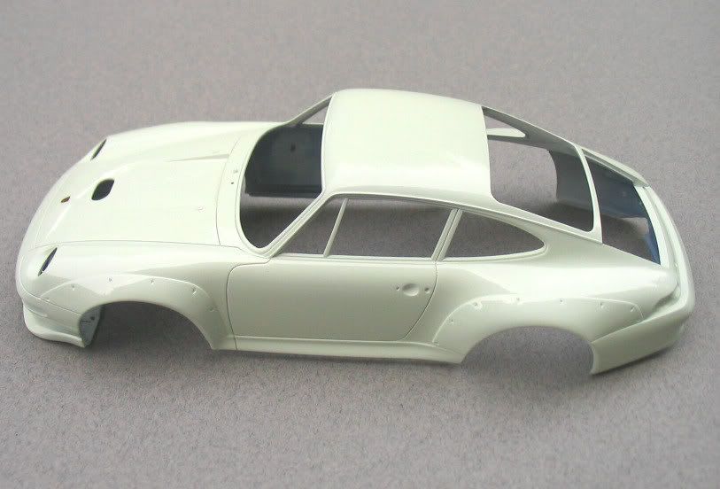

So that's what I'm going to do with this one- a simple trackday toy. Mostly out of the box, as I really want to finish this one. But not strictly out of the box.
Paint is PPG acrylic lacquer white, from the remnants of my stash of CobraColors. It's been clearcoated, and is ready for polish. My wife has decided that the GT2 in white looks alot like a Beluga whale. Can't say I disagree. So I gave it a blowhole.

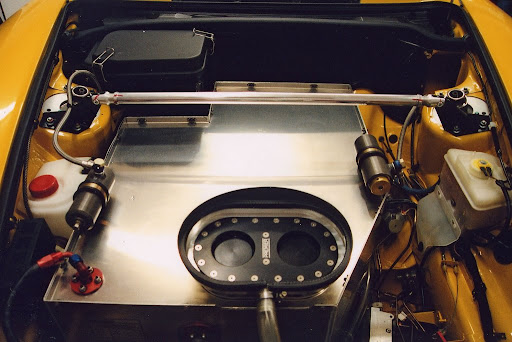

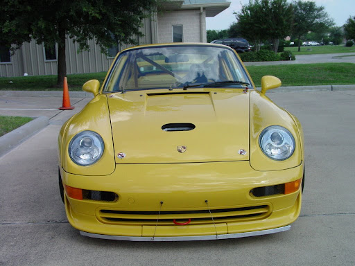

Like most 911s, the 993 GT2 has its fuel tank up front. On racing/track cars, a dry brake fuel filler could be mounted in the center of the bonnet. The Tamiya kit has the outline of a hinged flap covering the refueling receptacle. I decided that cutting it open would give alot of visual interest to the body.
This is the look I'm going for. But of course with the flap cut open, something has to be put into the hole.
Something like that thingie there. So off to the machine shop...!

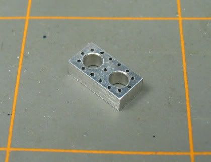

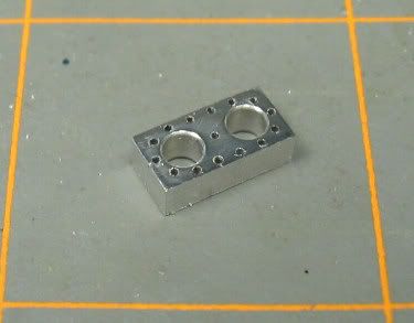

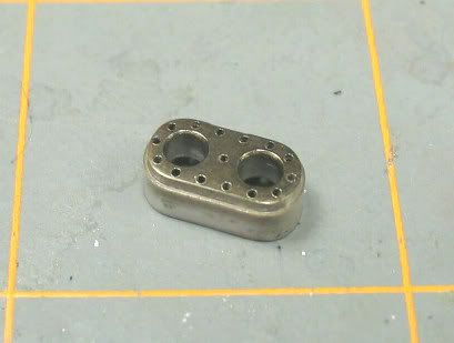

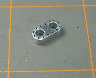

I started with a small block of aluminum, and drilled a bunch of holes in it.

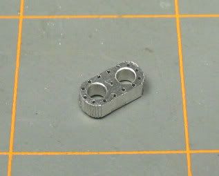

Then, something had to be done with those square corners. So I step cut them off- same way I make oval air cleaners.
Lots of math so far, but it serves a purpose. If all goes well I simply file down the steps and come out with the oval shape I want for the part.

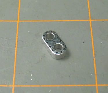

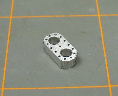

Filed and polished. So far so good.

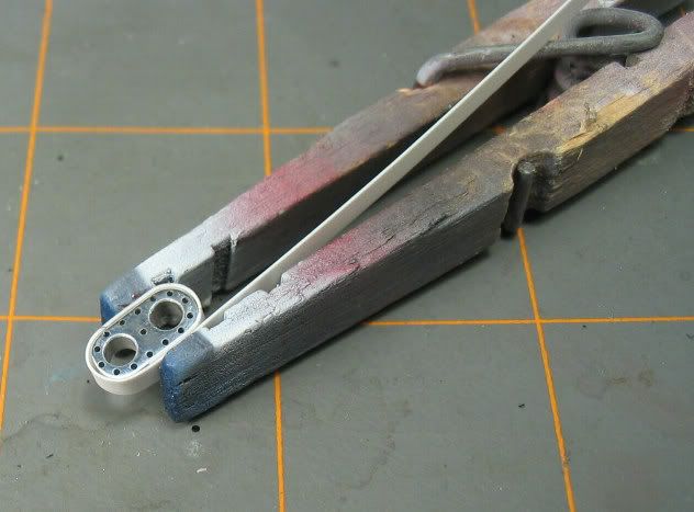

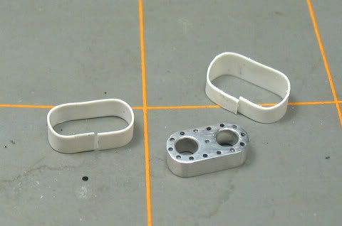

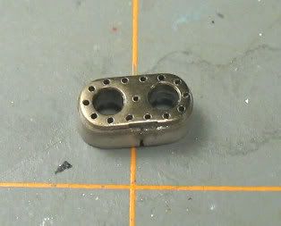

Next I wanted to add the sill and flange around it. I decided to go with plastic strip, shaped around the part.
This is Evergreen styrene strip, wrapped and clamped to shape. Of course styrene has the useful property that it can be heat shaped. Dip the strip in boiling water, and it will hold the shape it's formed in.
I made two, one for the sill and one for the flange.

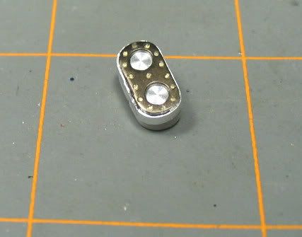

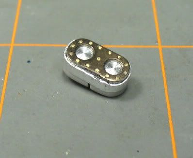

The part was painted with clear smoke, to give it an anodized look.

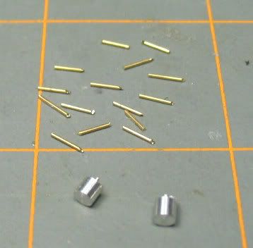

And fifteen small brass pins and two aluminum plugs fit into the drilled holes.
Ready for mounting. Time to polish the body and see how it will look in place!

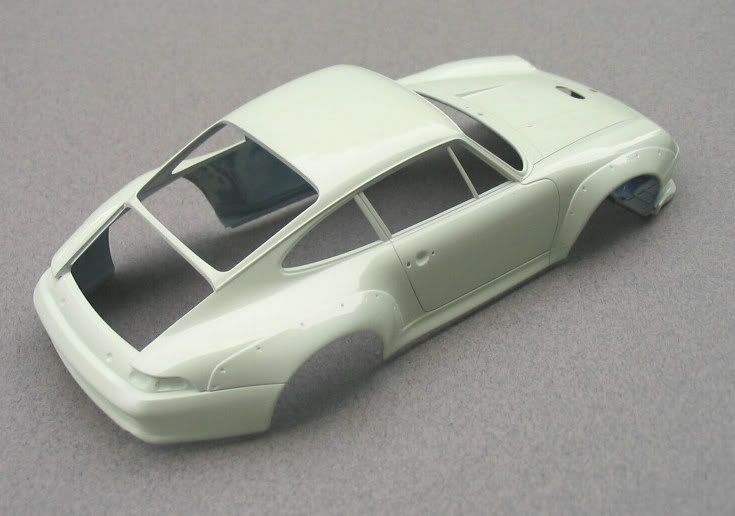

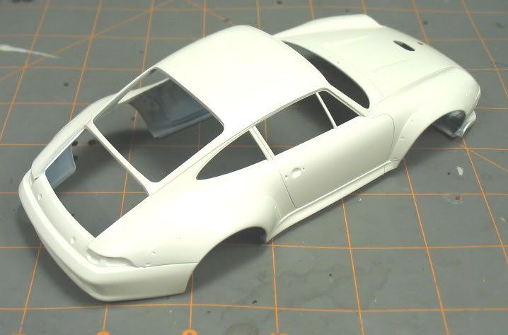

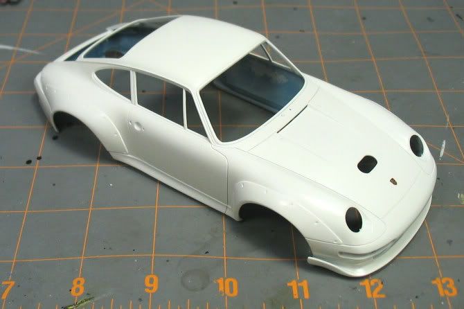

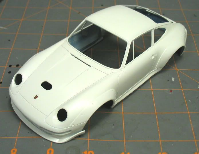

Polished and waxed!
Of course I still can't manage to take a decent pic of it, but I've convinced myself that the GT2 really will work in white.
I polished it up with my usual method. After giving the clearcoat a week or so to outgas, I rubbed the whole body with Tamiya Coarse compound. This takes of any texture from spraying the clearcoat. It's the most important step in polishing, and it usually takes me three or so sessions (washing and inspecting in between) just to make sure that no spots have been left unpolished. Next the whole body is rubbed out with McGuire's ScratchX (OK, I know it's not spelled McGuire's- it's something alot closer to Maqirye's, but I can never remember what, and 'McGuire' passes the spellcheck ). Then comes Tamiya Finish, and finally wax. The paint and clearcoat have never been touched with Micromesh (personally, I hate the stuff). This gives two advantages- the nearly impossible to remove haze of fine sanding scratches never appears to begin with, and there's much less chance of sanding through the paint/clearcoat. But of course if the paint and clearcoat go on well, it doesn't take much work to shine the body.
I've discovered my favorite thing about painting bodies white- getting polishing compound out of panel lines is no trouble at all! I scraped it out with my usual sharpened bamboo toothpick (holds a point much better than wood, but not so hard as to be a large risk for scratching the clearcoat). But it really doesn't seem to matter if the panel lines are spotlessly clean or not.
I've always considered white to be a terminally boring color to paint a car- not as bad as gold or brown, but close. But as this one seems to be turning out, I might just reconsider....
