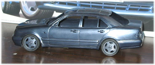

here's a pic of the car so far. i've sanded down the mold lines and glued on the bumpers.
the stock ride height looks a bit embarassing for being labed as the AMG sports version so the car was lowered about 1mm at the rear and 2mm up in front.
the headlight housings were drilled out to accomodate the LED's and plastic tubing was used for spacers/mouting brackets.
it's now ready for the primer.

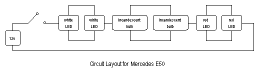

using a breadboard, i devised the following circuit for the LEDs and the incandescent bulbs for the mercedes:
this time, you'll need a 12v source as the parallel incandescent bulbs would draw more current than what a GP25A (9v) battery would be able to supply. this battery is quite compact, not as small as the 9v one but it will do as this kit has quite a bit of room under the body and a long hood area for the switch and wiring. the only thing you would really need to worry about is making the battery casing which would take up most of the space. on some kits, you'll have to resort to the 9v battery as it is shorter and necessary as the kit width may not be enough to accomodate the casing and wiring.

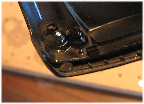

i drilled out the headlight housings so that the LEDs can fit in there. however, it looks really bad if you have an LED sticking out far into the headlight housing... just plain ugly so i made spacers out of styrene tubing so that just the crown of the LED sticks out into the housing. this way it just looks that much better. it may not make a difference with the clear lenses on but knowing that there is a bracket there gives me peace of mind that the LED is firmly set in place in the form of styrene reinforcement. i did this for all the lights. the body has had two coats of paint on at the time of this post so it's a bit hard to tell where the bracket ends and where the body begins.
