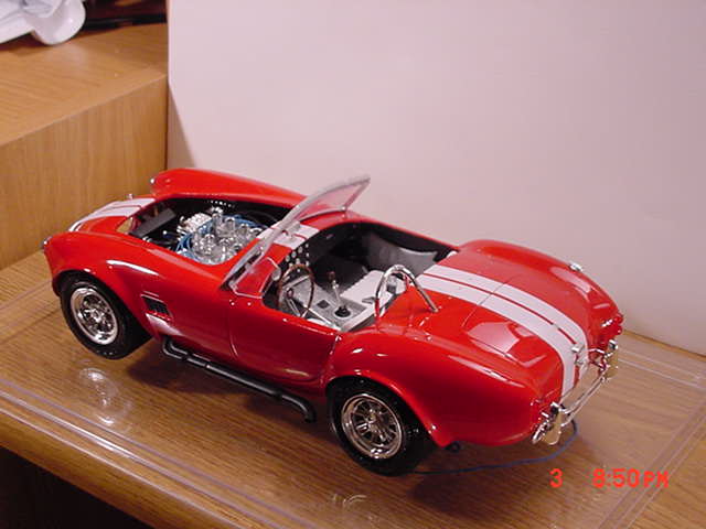

By the by, here is a picture of one of models that I posted in another thread. I used PlastiKote spray on it with no clear coat. I had to wet sand it and polish it out a little bit. I think it is an acceptable finish.

looks better than anything ive EVER made..nice..i lll have to get some of that plastikote stuff
