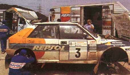

I love Delta and Carlos Sainz is my HERO. I have this kit in my home stock.
If you want built dirty delta here is foto from service.
Seweryn

Wow... the photo in the last post (thanks NY2000) seems to prove that the exhaust pipe was still running to the rear of the car on the Acropolis version...!
and we can easyly notice the rear wing color, too...! it's blue, like repsol stripes, no doubt !
Phil
