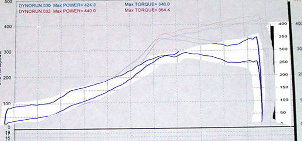

Here is my 351 rwhp dyno vs the 440 rwhp dyno.
I trapped 116/117 in August of last year with the 351 and I am still trapping the same with 90 more rwhp and 65 more rwtorque.
This baffles me:

Are ya at a different track? Or do ya have a high side chip that you could be hitting? Something has to be causing that, lol.
Has your ET came down?

My times/mph are staying constant ... at this point, our best guess is that the ignition is breaking up under load.
