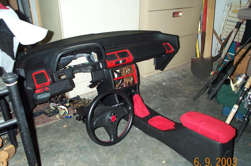

i took the dash out and took it apart to wrap mine. i seperated the two upper gray pieces from the two lower charcoal pieces. if you look on the backside of the dash, theres plastic welds holding it together, along with the most assenine glue ever used. i melted the plastic welds, and cut the glue with a dremel tool. then the pieces just snapped apart. the piece with the defrost vents is one part, with the padded gray piece on that. then the main dash, which i wrapped on each side, and down the center shelf. the charcoal padded part comes off in two pieces, a small one on the left of the cluster, and a long one on the passenger side. i wrapped the fuse cover seperately, and the glovebox too.
the flat panel where theres places for extra buttons was another piece i wrapped seperately, and i just wrapped right over all the button blanks, since i figured id never use them.
Thanks for the advice!!!
you have any pics of yours?
I'm pretty familier with taking out the dash.. I had to do it 3 times for the freekin paint..

over 10 grand in parts, and about 300 hours of labor, and i only spent 3k. and then Katrina filled it with mud.

lol old skool NES in the glove box, thats hot. THat looks really nice incucivic. The red accents look clean.

if you mean me, yeah i guess i am. its an 88, and nobody rocked PS2 or DVDs in 88, so the NES gets the spot.
if you meant someone else, it still could be said for me
