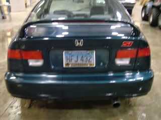

How do these look?
I don't have any close-ups but what do you guys think of these taillights??

Schister those look bad ass, I'm gonna have to try the same thing, cuz mine's that same color, model, etc. and that looks very nice.
