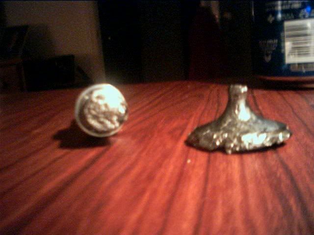

I know this isnt a vary good pic, Ill get better tommarow. Its the head of one of the intake valves and the bottom of the spark plug. The entire combustion chamber in the head looks like the bottom of the spark plug. dmbrisket, that is deff a possibility. Ill check with him in the morning and see what they are made of. I took the distributer off myself, It was very tight and still aligned.

just a total guess, but at 5 grand, and if thats the bottum of the spark plug, i would say there was a melt down ( a void like i mentiond above), just a little to hot and it gave in and that is what he wound up with, and it would explain the lack of shrapnel found (unless its in the bottum of the block yet)

sounds like a heat transfer problem. if all the valve heads snapped off, then they likely were getting too hot and finally gave in. could have simply been the wrong spark plugs. also coulda been the seating area of the valves being too thin. by the way, there is no such thing as early detonation.
looking at the pic, it looks like sumthin busted loose and had a chance to dance around. also like mentioned a melt down in the cylinder coulda happened due to over heating. looks like aluminum got splattered around. pre-ignition could wear a hole in the piston, detonation would be more likely to bust the piston skirts. looks like it might have been a combo of bad heat transfer and pre-ignition.
