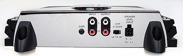

I could probably put it in with about 15 min cause the wires are already there. I want to have my subs back!! Anyways, Ive yet to hook it up cause im confused. This amp has a "GAIN" knob that im not quite sure what to do with. My old amp did not have one. My question is, do I need this GAIN? There are no numbers on the knob itself, so how do I do this? I think it has to do with the headunit preout voltage, right? How much do I turn the knob? Is this some sort of guessing game?

Heres a pic of the amp that I found on the web, so you can understand about the GAIN knob.

I don't know much about the technical side of things, but if memory serves me correctly, the "gains" knob controls how much power (bass) the amp puts out...in layman's terms, if you turn it all the way up and blast your system you stand a good chance of blowing your sub. I had this happen to me before I met Alex...a shop installed my amp with the gain all the way up and less than 2 weeks it blew my sub. When I took it back they said "Oh your amp volume was all the way up".....IF A SHOP EVER REFERS TO IT AS VOLUME, GET THE HELL OUTTA THERE!!

I took a look at there website from the link you provided, but it wasnt very helpful, so I checked the box and gave them a call a few minutes ago and they were quite helpful and were able to explain it to me. I also told them what subs I had, and they told me where to set it to start (approx 1/4 - 1/2 turn) , and then I can make small adjustments from there.
Basically exactly as you said, in my configuration it controls how much bass the amp puts out. According to the tech guy at MTX that I spoke with, If I ran the gain to the max all the time, I would definitly blow the subs I have after a while, as the "performance certificate" that came with the amp shows it to be putting out quite a bit more than advertised! Also, if I keep the gain turned down a bit, it will also keep the amp running cooler which will avoid cutting out due to high heat.
