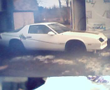

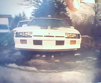

Bad pics of my car without my chrome rims.
