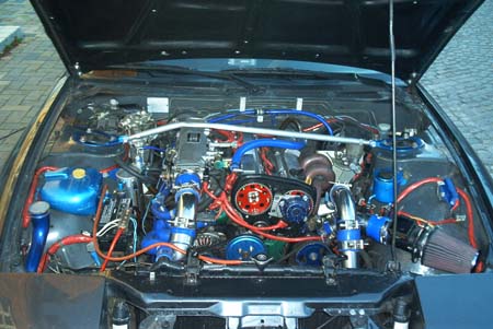

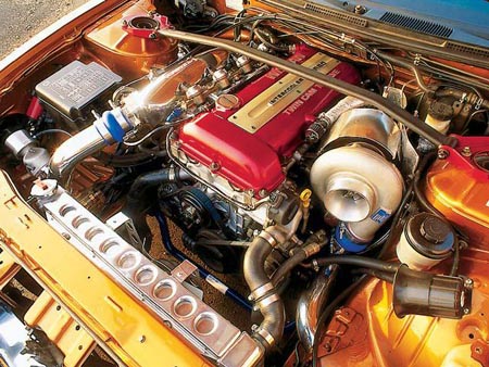

Is there really any advantage or disadvantage of having a top mounted turbo manifold http://www.stockreco.com/01sap.jpg or a regular bottom turbo manifold http://www.stockreco.com/picture1006.jpg ???

the main reason people do topmounts is for fitment. its usually too big to mount it in stock location.

The top mount gives easier acces to the turbo. Bottom mount allows for most of the downpipes made to be used. Top mount runs the risk of melting stuff in the engine bay.(i.e. brake fluid resovoir, wires, spark plug wires, just in general "shit").

No, i was just posting that pic to show a reference of what i meant by top mounted so i wouldnt get a bunch of ppl confused on what i mean LOL...

Heat is energy. We all know that. Too much or too little can be a bad thing. You want the most heat from the engine to be run through the turbine housing. Exhaust pressure, heat, and noise energy all transfer from the turbine housing to the compresor. Heat is the enemy on the compressor side of the turbo. An intercooler is used to dissipate heat created by the compressor. Most of the heat is created from just compressing the air but some is just transferred over by the turbine housing. This is why sizing is important. An improperly sized turbo can create much more heat than a properly sized turbo because of its efficiency range. You want at least above 60% efficiency. You can be picky and choose higher percentage, but 60% is about as low as you would want. Don't use wrap. Get the manifold ceramic coated. Wrap will destroy the manifold very quickly. Niether position is greater than the other for cooling. An oil cooler or water injection would be the best way of cooling the turbo faster. Niether spools faster(unless you assume that hot air is lighter and will rise into the turbo but that is irrelevant). Sideways is pretty much impossible on a 240.
