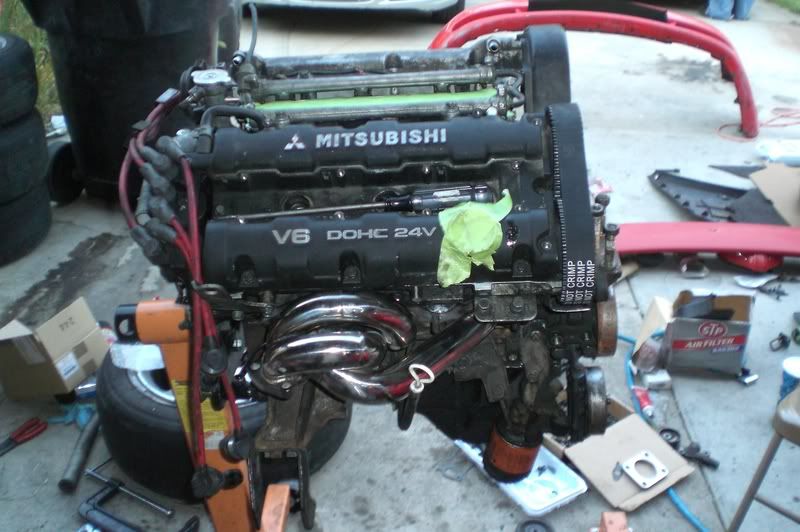

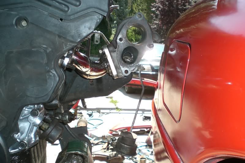

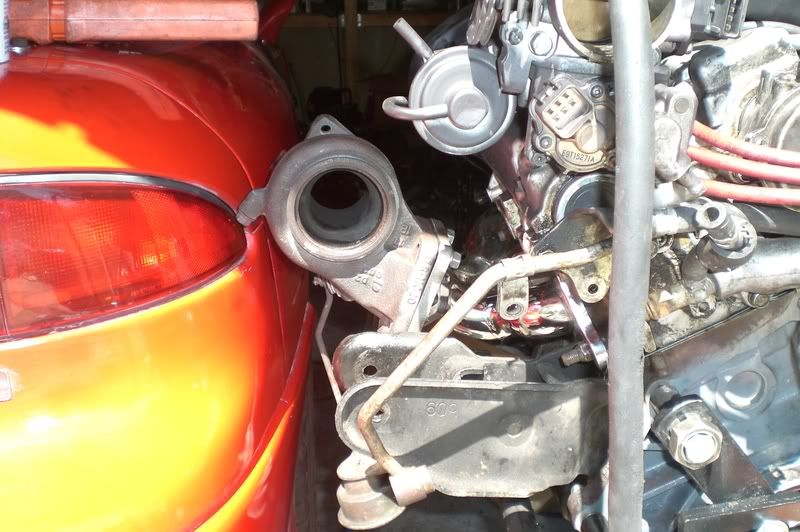

Ok I need to take some pictures.. and post!! I am going to put the motor together on saturday and get it ready to drop in.. then I am going to fab my manifolds and downpipes (Dumping under the car) and then I have 4 Races set up.. Evo X with bolt ons, Evo 8 lots of bolt ons and cams, mustang cobra ran a 12.3, and a 240 with the SR20det swap fully built..

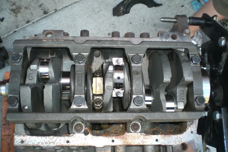

Finaly!! I got some pictures!! sorry this took so damn long!! and I was supost to finish this by friday.. but my Frickin turbo never showed up1! AAARRR
