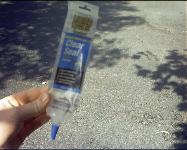

Pretty much any silicone will work but I nabbed this stuff because it was just laying around at my parent's house
My camera sucks, but I you can almost tell I did a really good job. If I would have used some kind of black or gray shit, you'd be able to see every little mess up.
