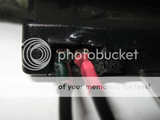

The module is a little melted, but it works good. I have a question later, so here is the melted part.

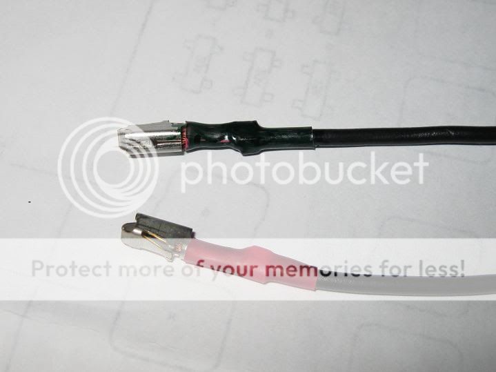

I need the plug. I went down to the autoparts store. He looked up that part, and found clips (not the plug) that are the same, from GM. I put wires to them
Here is what they look like plugged in.
The module works, but the plastic is a little melted. The plug (PT1183) is melted beyond repair. I showed the module to my friend Brian, and he said, "you can't use that, you have to buy a new one." He is so insistent I can't use it, he refused to offer anymore help or assist saying, "if you burn up, I'm not going to be responsible." (He is a nice guy, who has my best interest at hart, but his past record is, when he wants to help, he does, but if he doesn't want to, he makes any excuse, even ridicules ones you know are false, because he doesn't want to do something. Not that this is one, but in the past).
My reasoning;
1. The module inside is a electric board, with stuff soldiered to it. Because over the years, it got hot, the cheap plastic melted a little. This doesn't have anything to do with the mettle parts inside. I could paint it, doesn't effect inside. I could get some harsh sand paper and scratch the plastic so it looks very bad. Again, if the insides are good, it doesn't effect the electric parts. The fact the plastic is a little warped, doesn't mean the module is bad.
2. The plug has two mettle female receptors. If I use GM clips that are for the prongs inside the module, the electric doesn't know it's not the plug PT1183. They fit snugly in place.
3. If this was a big ignition wire, that's used all the time with lots of current, I'd probable not do this. When I was testing, I touched the wire while it was hot, I saw a slight current. No spark, or pop, just a little current about the size of a human hair.
Also, since I started looking into this a couple weeks a go, I've not had to use the defogger at all. We are talking about a few times a year, for what, 5 minutes before it goes off?
I figure until I can find a car with a good looking module and a plug, this will be OK. Who knows, I may not even need to use the defogger until next winter.
Here is what the project looks like completed.
I turned on the defogger for a few minutes and kept touching the module to see if it would get hot. The thing never got warm or anything.
Brian told me I was stupid to do this, that I don't value human life.
I wanted to ask the experts. Are my reasoning's OK. What am I missing? Is this job that I did the wrong thing to do? Is my life in danger?
I want to add something as I end. With Being not confident in myself, being a little down, when I got finished with this, sitting in the backseat looking at what I did, I felt sooooooo good! I could not believe how good this made me feel. I did this whole thing by myself, didn't have to pay a mechanic or get a friend to help. I followed through all the way to completion of the project.
This gives me a lot of confidence and is a very positive thing for me.
These clips I used are GM clips. Will this temporary job put me in danger?
Thank you for any feedback, and think you for all the help.

I would recommend that you tape up farther on the connectors to make sure that they never touch. I would not make this a permanent fix though.

Good job Chris! If the module is is working, why do you need another one? BTW, you're life is not in danger, the module & connectors would blow a fuse before they ever got hot enough to cause any damage, so you can tell Brian to kiss you're arss!

I wasn't going to buy a module, just was wondering what rockauto price was. I see it's all over the place.
I found out something. If I have the radio station on a weaker station, when I turn on the defroster, the station gets lots of static.
Wonder if it could be since the plug is missing, there's no insulation from one clip to the other?
